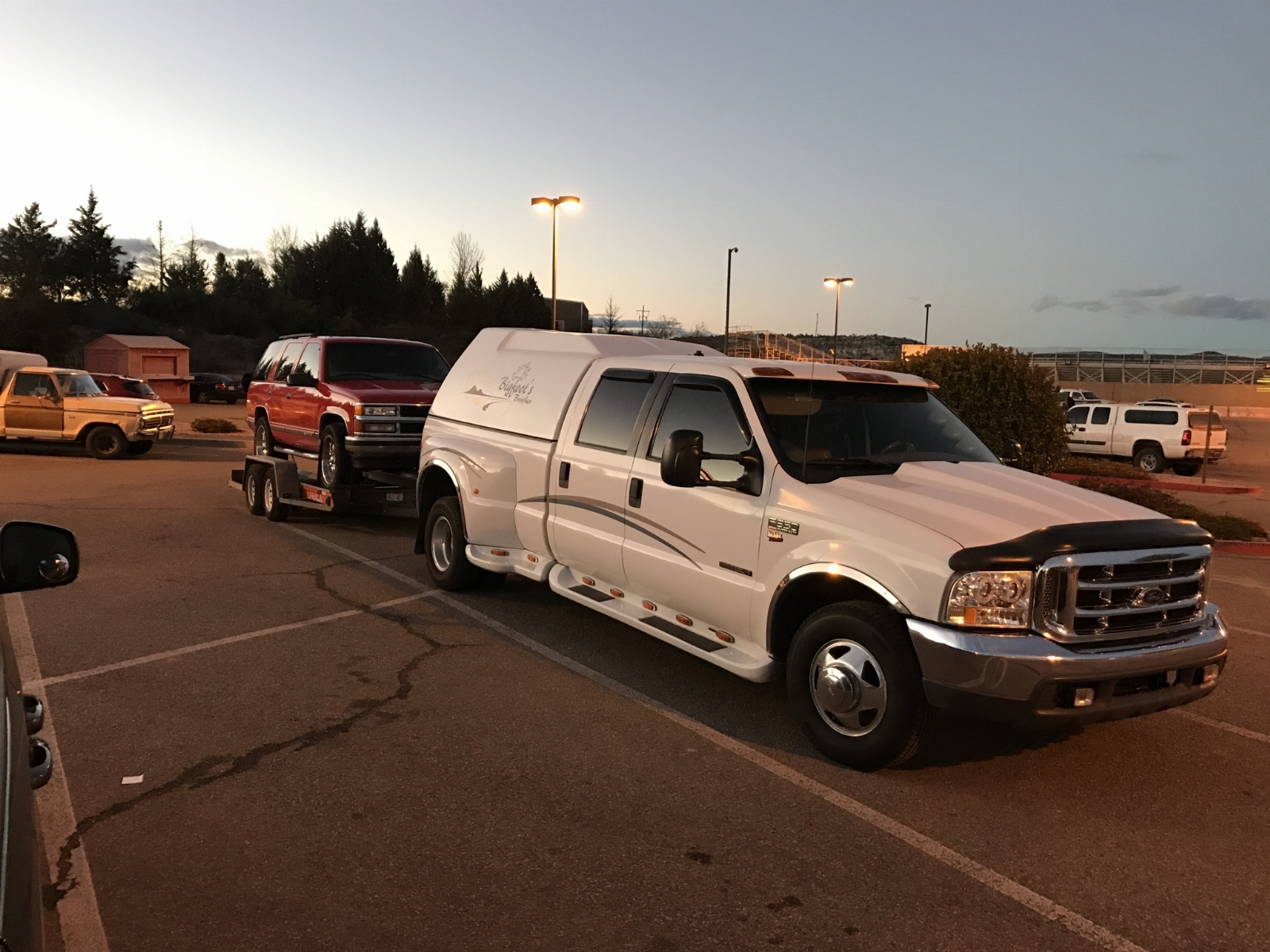

When my 99 developed a crack in the torque converter hub and puked trans fluid all over, I rented a Uhaul. Can’t use a WDH with surge but my 7.3 PSD towed it no problem.....of course it’s overkill but my current 13 Tahoe could have handled it in the AZ mountains with some sweat. It fit with a few inches to spare, and that was with 20” wheels that stuck out a little.
