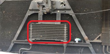

Look through your grill and if you have one it'll be between the grill and the A/C condenser:

Look through your grill...
An excellent single-sentence tutorial; I do have a transmission cooler!
