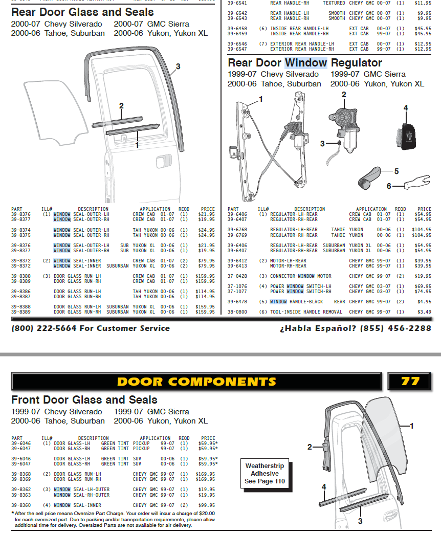

LMC Truck (LMCTruck.com) has the seals and the glass runs (door seals are on another page in their catalog):
