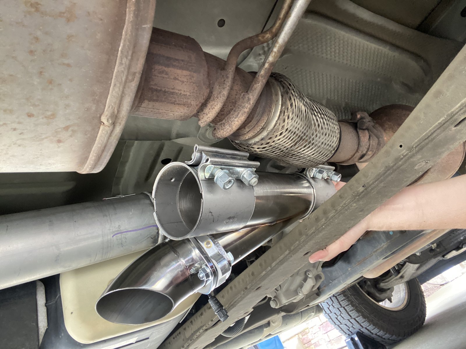

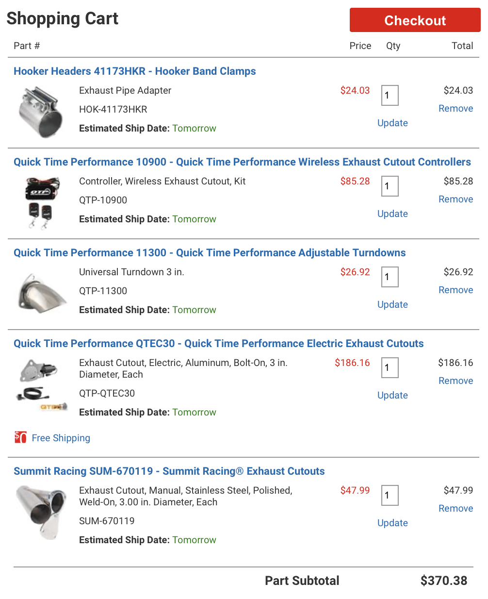

Well I'm pulling the trigger. I anticipate some time home from work in the next few weeks so I could use a fun project.
Getting a Summit Racing brand Y-pipe because I've seen bad reviews about QTPs pipes, but will be using QTPs valve and electronics. Will line it up flush and use these butt clamps to attach for now, then I'll be able to have my exhaust shop weld it if I want it more permanent. Wish me luck!

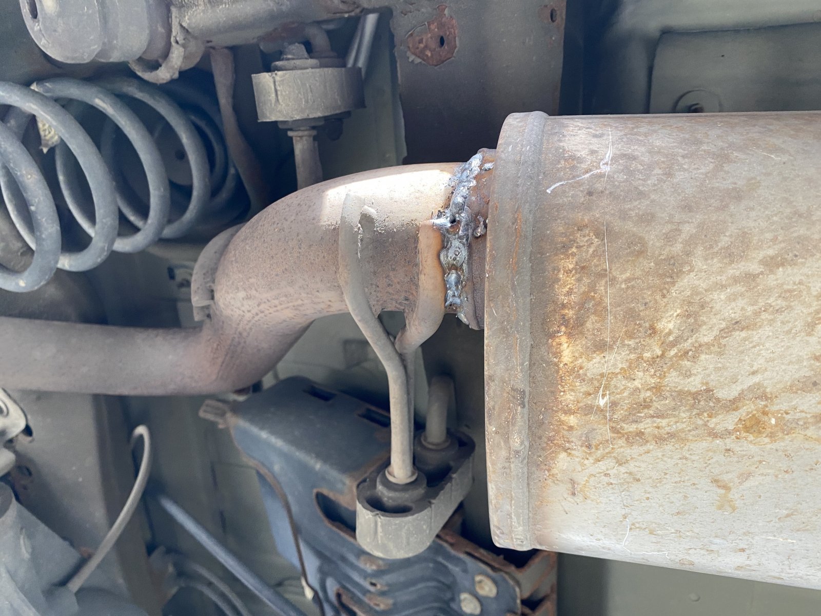

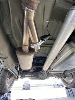

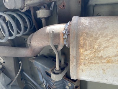

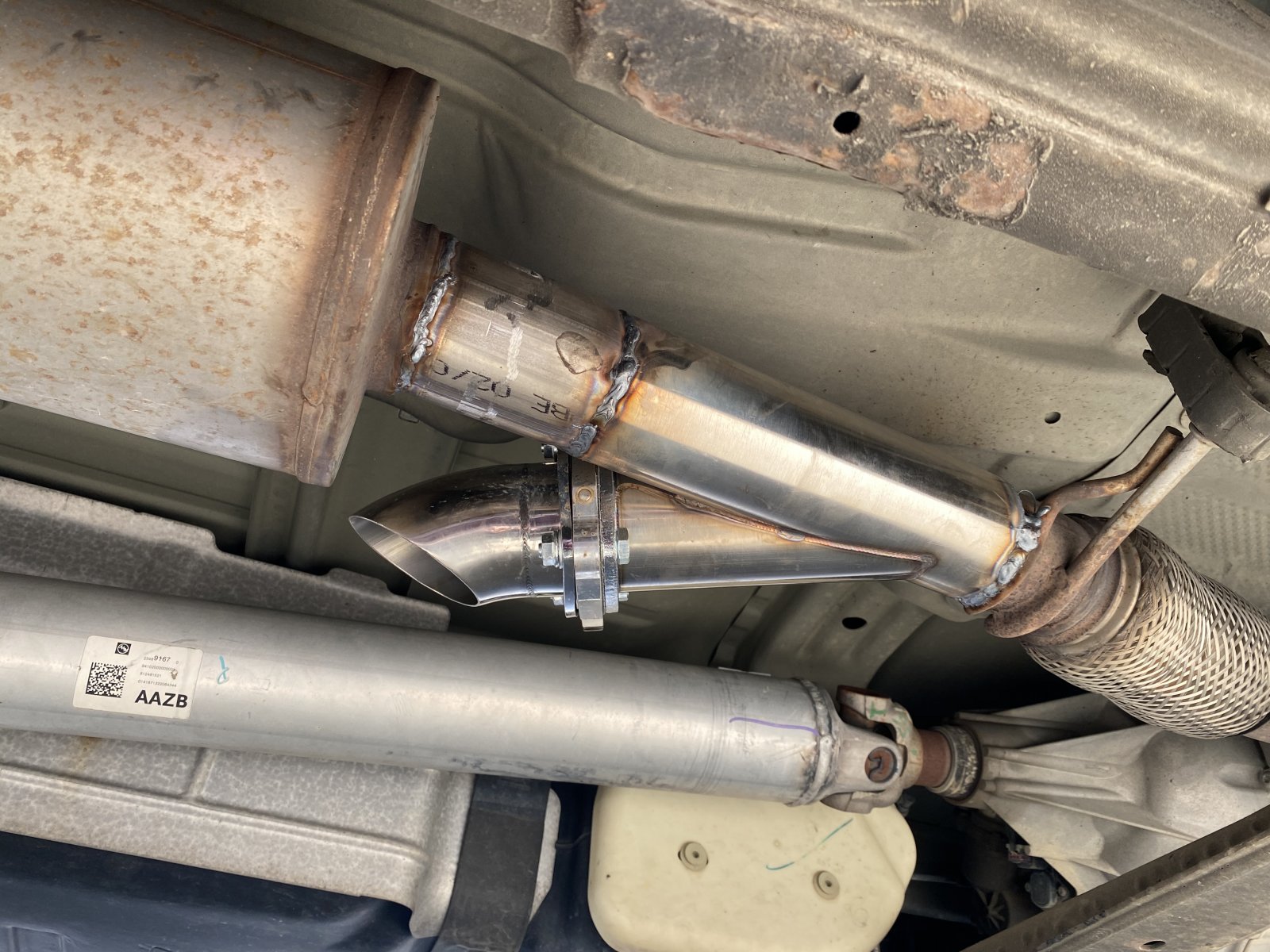

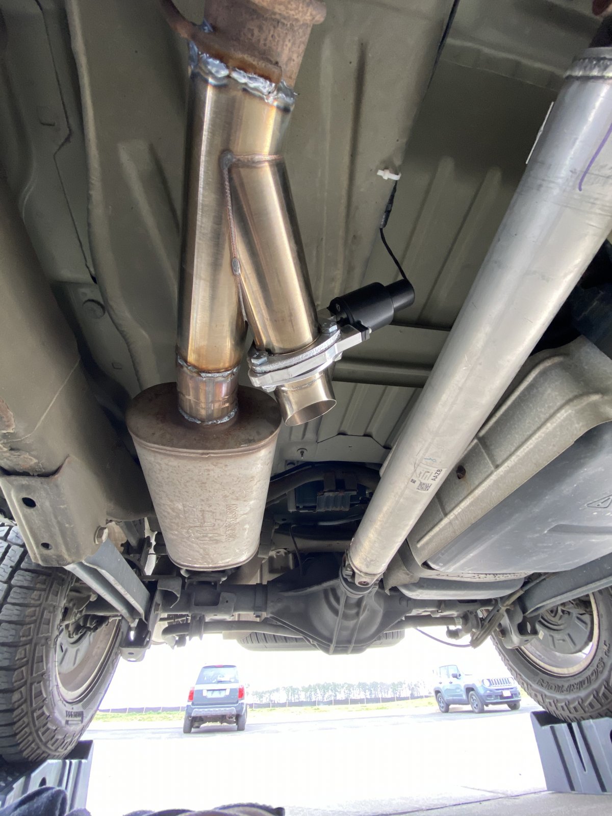

Cutout is in. Clamp idea wasn’t going to work so I had my local exhaust guy weld it in. Guess I didn’t realize there wasn’t much available straight pipe to use (pictures I had seen were from Silverados or Suburbans with longer wheelbase).
He ended up cutting out the flapper and extra straight section behind the muffler, moved muffler back a few inches and putting the cutout right in front of the muffler. Here are some pics before & after. Turn down isn’t as close to the driveshaft as it looks. Will get better pics and video soon.

Awesome, Matt!
Thanks for running with this. What's your impression? Does it sound stupid? Hilarious? Any regrets? Do you notice the absence of the flapper? Are you running partially open at times? Where did you mount the switch?
Sorry for all of the questions! Just a little excited over here....

I love it. Stupid loud, but doesn’t sound stupid. Yes it’s hilarious, but no ragrets nam sayin. It’s hard to tell when it’s fully opened or closed, I just hold it about 8 seconds. This makes it a little hard to find the middle. It’s not really a gradual volume adjustment, it gets to like 80% volume right away.
No switch, I got the wireless remote module, but I have that mounted across from the battery in the engine bay.
I welcome other questions, I’m excited about it too. Still smile every time I open it up.
Still working on taking video when I get time.

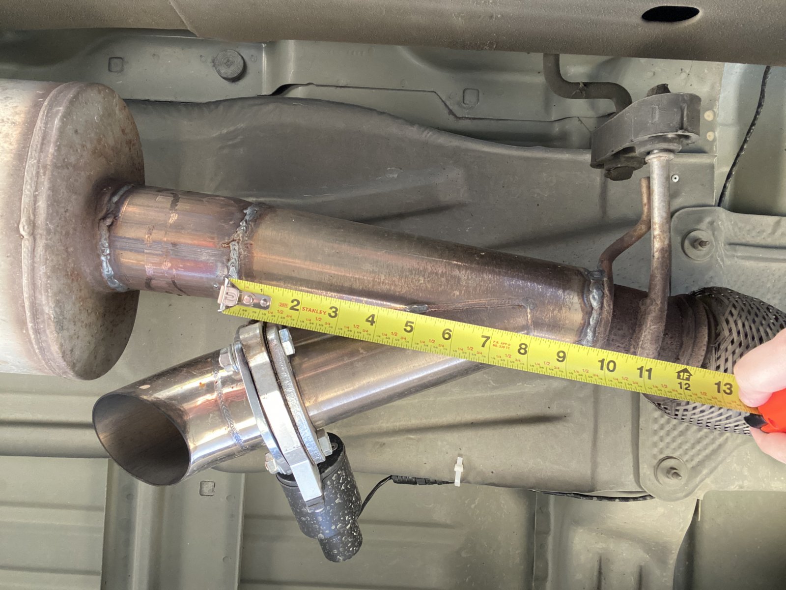

hey Matt, do you remember the overall length of that summit cut out? I read somewhere that they are 14 inches long? For whatever reason it’s not on their website. I’m seeing if I can make or find and cut down a shorter one in an attempt to keep the flapper without a bunch of work.

Just measured 10 inches from seam to seam. Picture is a little deceptive but I attached anyway.
