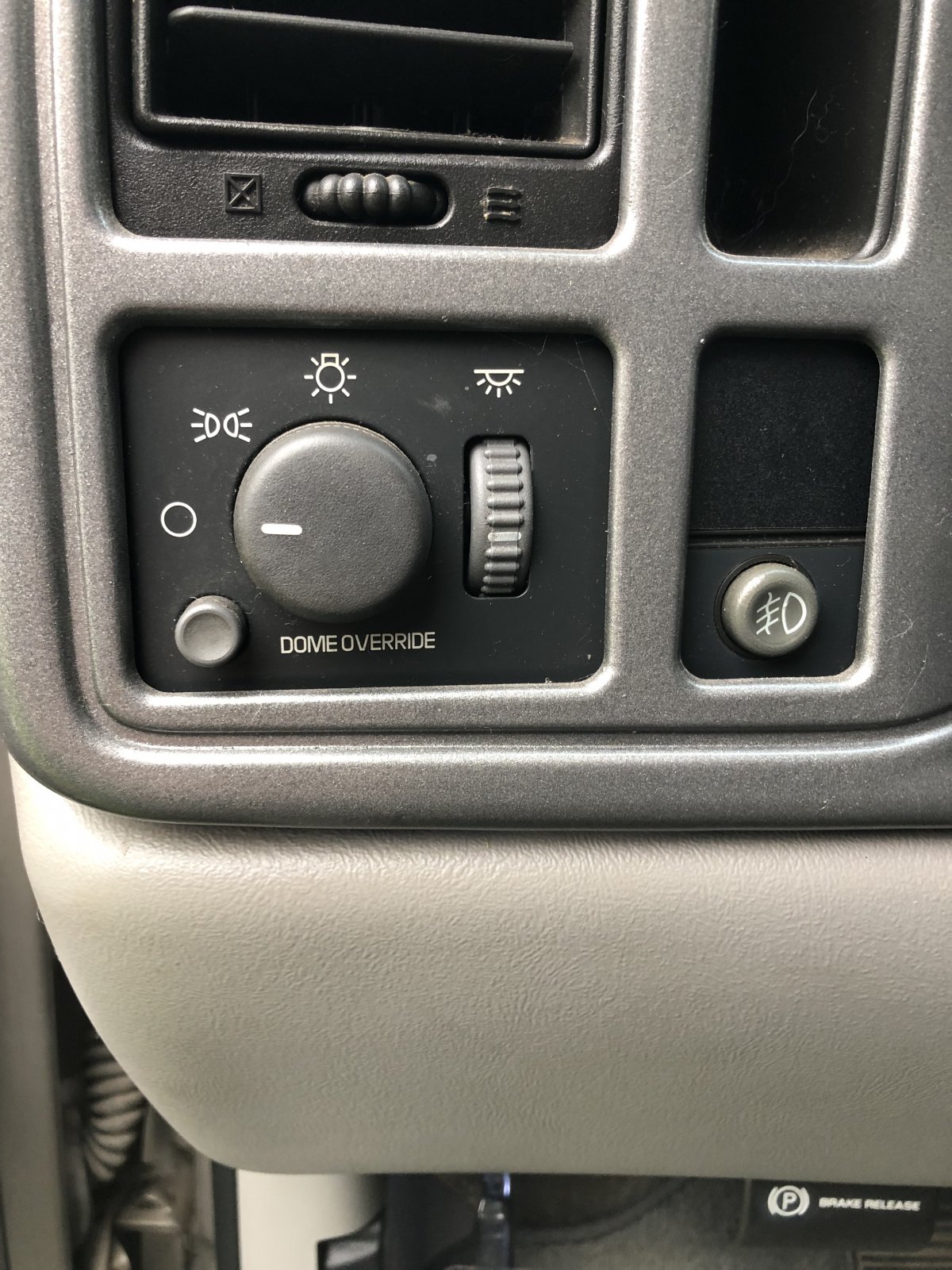

Maybe I spoke too soon, thought the lights themselves are perfect and they come on when either a door opens or when i spin the wheel on the dash upwards until it clicks them on, they do not turn on individually from the button that is right next to them....I thought they did yesterday and the old ones definitely did....
What button? The dome override button? That keeps the interior lights from coming on when a door is opened if its in the recessed position. It won’t turn on the lights per se, that’s what turning the wheel until it clicks does.

No the scroll wheel to the right, the one that dims the dash lights and turns everything on when you go all the way up until it clicks.....
either way, the map lights dont come on when i push the button next to either one, they do come on when using that scroll wheel....the buttons worked yesterday to turn on/off either side but not today

Oh ok gotcha. One thing I’ve found out is leds in these trucks act weird depending on the brand. When I was converting my 08 Silverado to led dome and map lights I had all kinds of trouble - the BCM got all kinds of confused and I had some weird issues. I think I ended up disconnecting the battery, waited a few minutes snd reconnected it. That’s what I’d try if I was you. It’s kind of like a reboot for a pc. The old saying with electronics- unplug them and then plug them back in fixes 75% of problems.
The reason those LED's were acting weird was probably because they didnt have a current limiting resistor. You can get LED's with them built in now.
