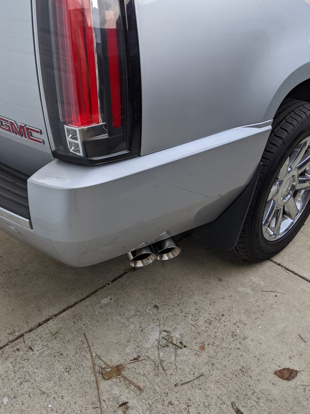

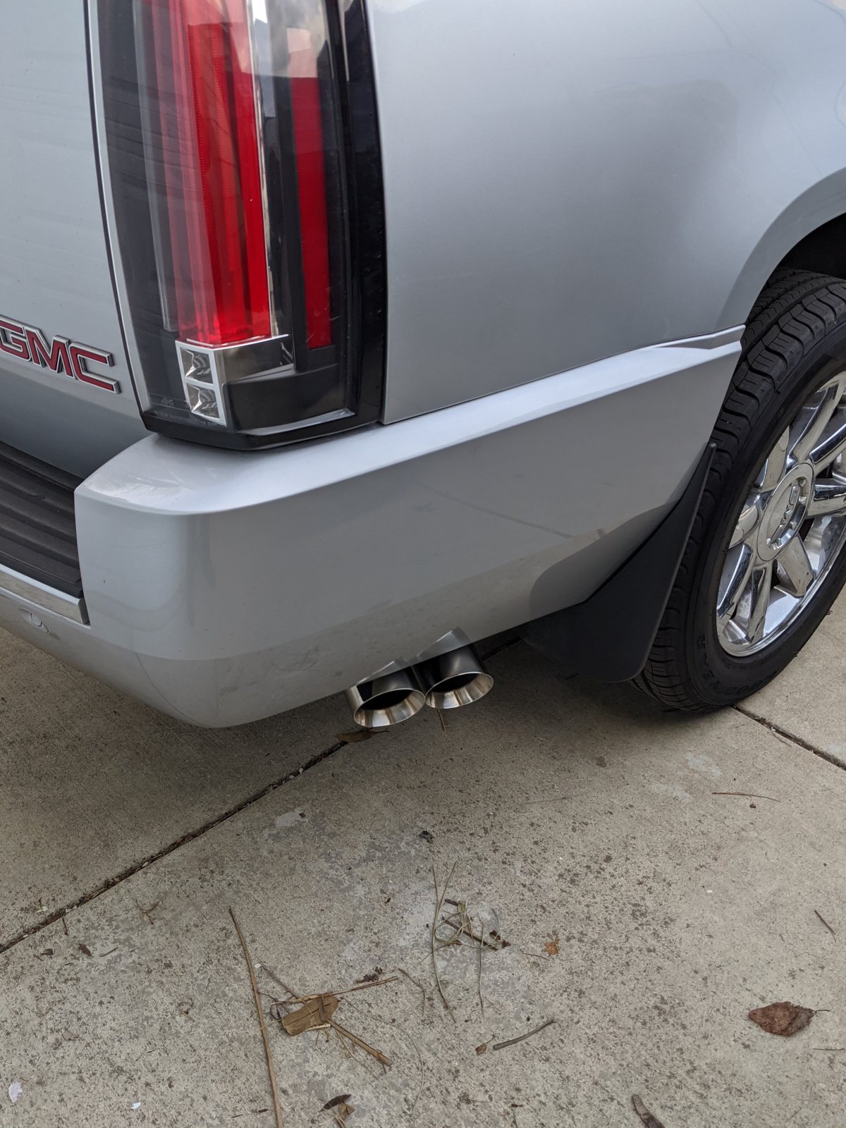

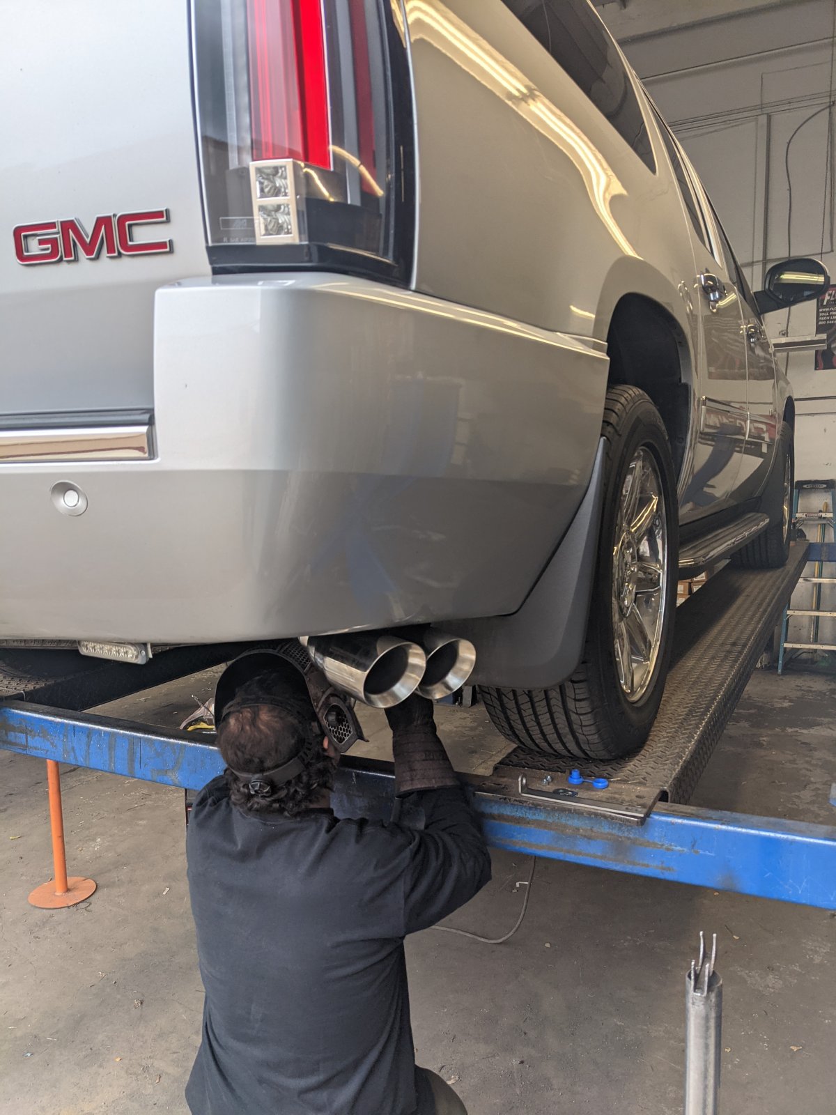

Lol $150 installed at muffler shop, that's a 3 1/2" w/4 1/2" tip's
that was for muffler back
30,750
48,441
Ok? Also the slp doesn't fit the 3.0 pipe on a small 5.3 like yours.
6.2L factory pipe is 3.5" some of it is larger, I have the Borla Sportsman 3.5 in 3.5 out, they didn't have a 3 1/2" pipe bender so it's actually 3" from the muffler back to the 3 1/2" in on the tip
all that doesn't matter anyway you can size pipe up or down easily. the 5.3 slp resonator delete will fit you just need to size the pipe, shop had a nice 4 1/2" dual tip on hand I'm not complaining
