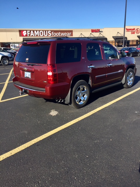

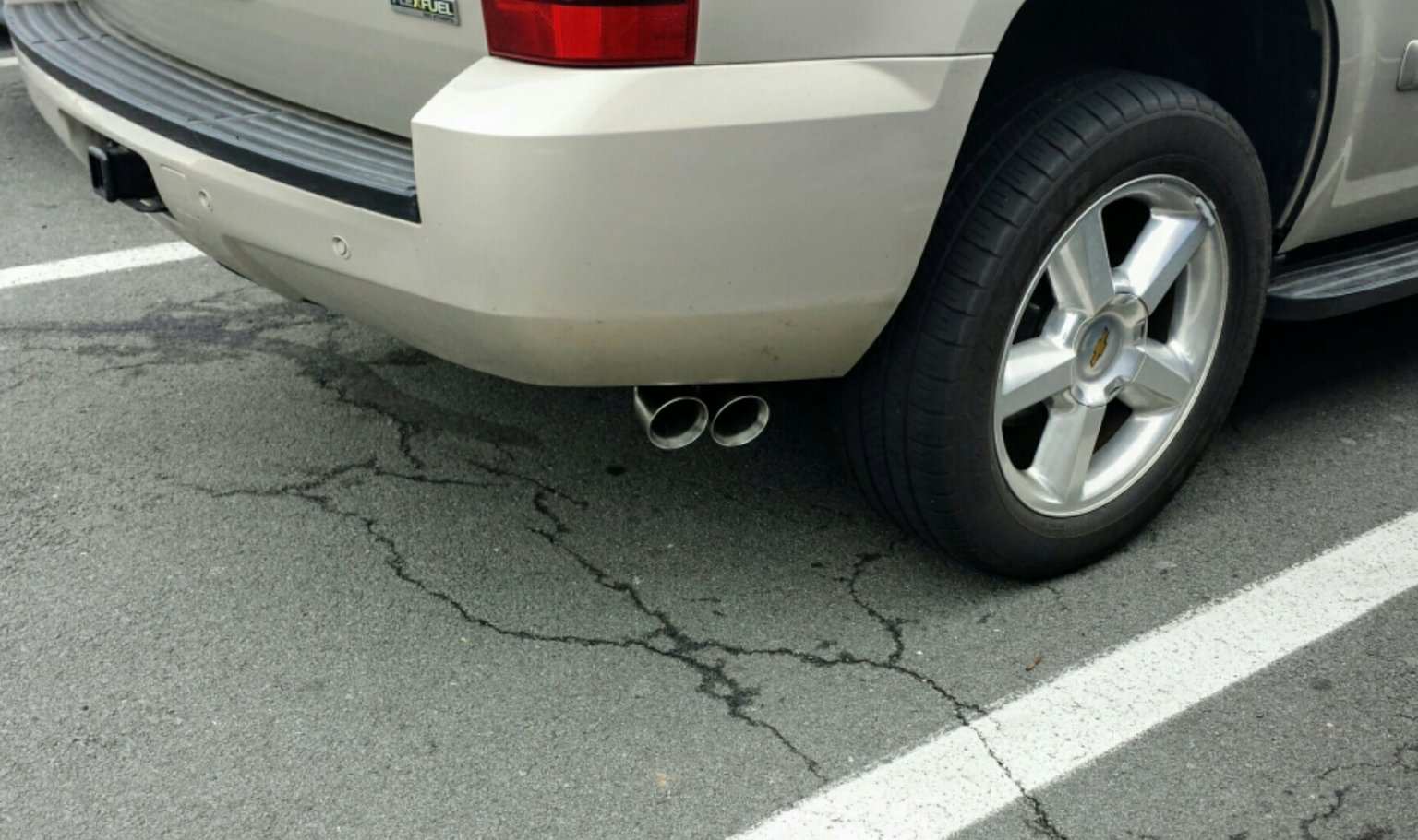

The pictures here (stolen from another thread) 2008 Tahoe LT3 with SLP Resonator Delete.jpg resonatordelete2.jpg are the look I'm trying to achieve, but bonus points if the tips are black. Love the dual behind passenger rear tire exit, parallel to the line of the quarter panel, sticking out just a hair.
