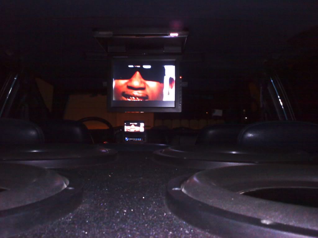

sorry guys thought i had a thread with pics
here ya go
ya the 15" was wayyyyyy to big to go over there i had to do it in front of the ac controls, its kinda pushed back but its only for show anyway i dont put people in my back seat lol
i ran the power wires up to my radio so it turns on when the radio turns on unless i turn the power off on the flipdown
