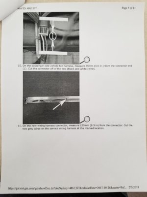

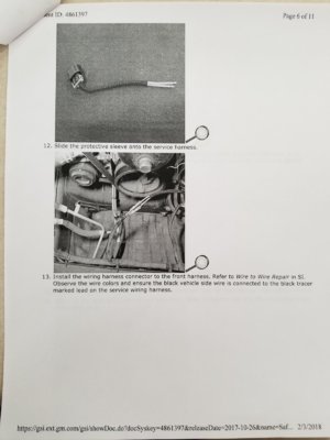

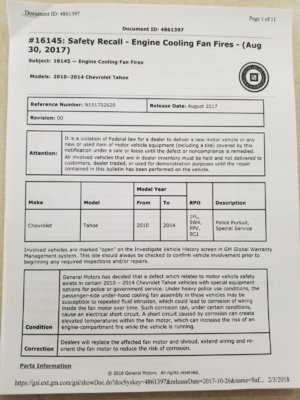

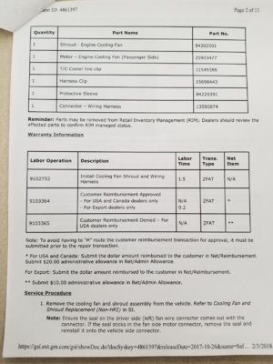

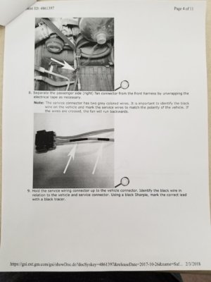

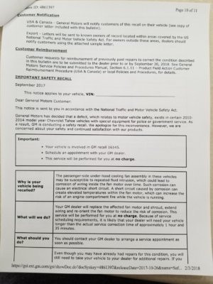

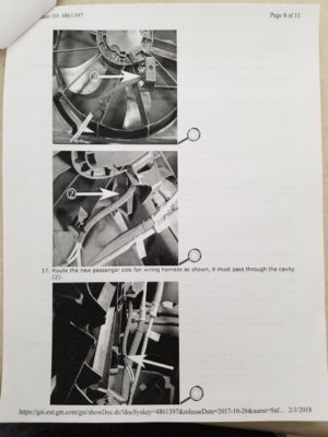

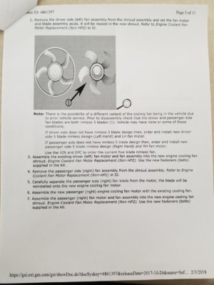

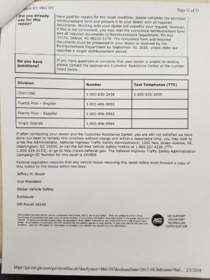

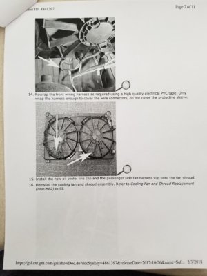

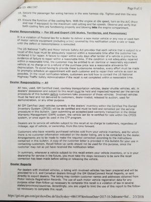

I had mine done today. Looks like they put a new shroud, new passenger fan motor and extended the wire harness. The service advisor printed the whole thing off for me if anyone is interested in it. It's about 9 pages of instructions with part numbers too.
30,614
48,137
im interested, I just bought a oem hd cooling fan assembly from rockauto, no idea it or any other parts I have may need to be changed or would fall within the recall.

to make sure you guys dont get jerked around like I did / other users in here... open the glove box and check the RPO sticker for "9C1, 5W4" if you dont see those, your vehicle is not affected by the recall. the dealer does not know any better.
