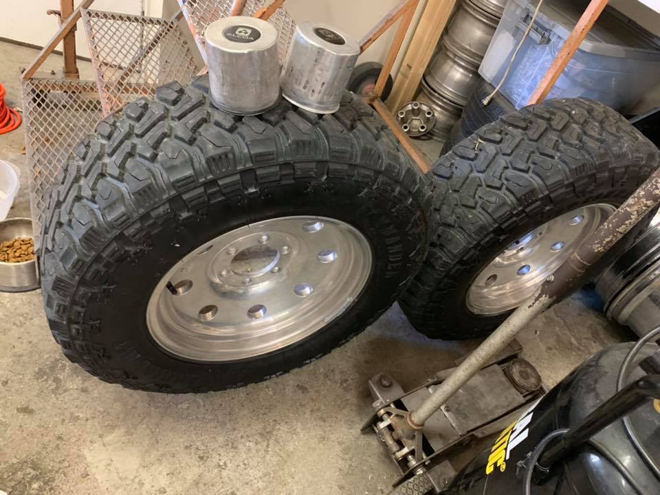

Hi guys! I looked around the internet and cant seem to figure this out. I found some 17" 6x5.5 Alcoa wheels off of a 96 parted out tahoe. It looks like they will fit but is there something Im not seeing like the lug or hub hole different?
Do you think that they will fit a 11 tahoe?
Can you take and educated guess about the offset of these?
The tires are 265/70/17

The bolt pattern/hub should be the same on a ‘96 and a ‘11 if I’m not mistaken. The tires should fit as well. Can’t speak about the offset, but they don’t look too far off based on the picture.

I think the 11 needs a minimum 17” wheel. The tires sb fine The bolt patterns are same and if the 96 is 4wd the bore should be too. I had a set of these on my 2000 Yukon
