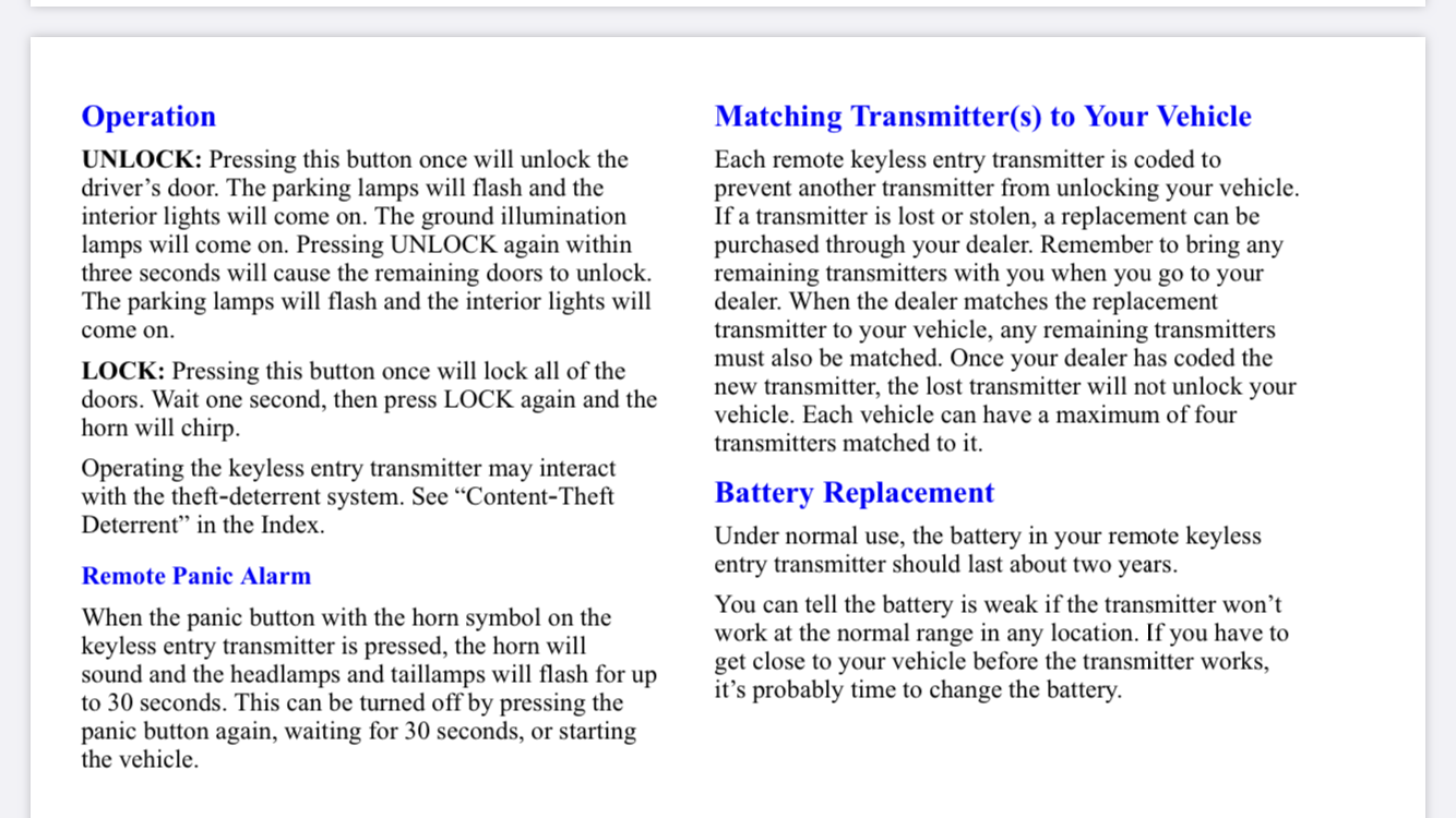

Can’t you just press the panic button again to get it to stop?
wjburken
Dec 26, 2017
10,315
29,545
Eastern Iowa
Not on mine, at least the 02. I have to put the key the ignition and turn it. Not sure about the 08 Silverado.
I’m pretty sure you can, or should be able to, shut it off by hitting the panic button again. I know I could on my ‘02 Silverado.
