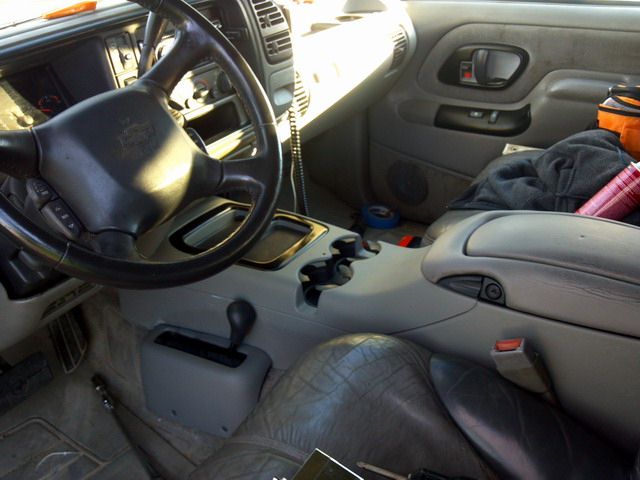

Ok, She's in, and looks pretty good. I am happy with it.
A teaser...
Console Install
Shawn
blue99tahoe24
bout that tahoe life
Nov 23, 2010
747
joliet il
Dude thats looks so sick looks factory how did u do the blue leds
Sent from my PantechP9060 using Tapatalk 2
95BlackTahoe
Dec 31, 2011
236
Edinburg, PA
Now comes the fun part...cleanup...lol...and I am going to make a few slight changes to the shifter cover and the shifter rod...Minor, and really not needed, just doing it for my taste. Overall, it came out good. I have the sub in, and I tested it on my sons Sierra aftermarket amp, and it worked, so I will complete that when i locate my connectors...ugh...

Yeah, it needed to be trimmed on the top side and the bottom as well.
Console Install
The above link may help in case you hadn't seen it yet...
Shawn
---------- Post added at 10:21 PM ---------- Previous post was at 10:18 PM ----------
I forgot to mention, in the one picture of the shift rod, it appears to be a little bent to the bottom...so to speak. I plan when the weather gets warm, to flip the rod...to see if that makes it any easier to get in 4wd...It's not hard now, just want to see if it improves it any at all.

well.... it's like this the weather was warm fri so i installed
the console and made cuts on the 03 floor shifter cover and
the knob will rub the console a little bit if put in N & 4 L
might have to look into a smaller knob like you seen.

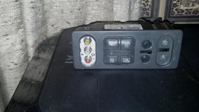

I drilled a hole in the cover to put a green light for the 4x4
indication . I hooked up thet bose sub and man.... that
little sub has some thump with the right LP filter i had it
at 80 hz. The other controls that faces the rear seats i'm
going to cover them holes and where the cd player was
i will make a pocket to make it a usable space and i will
check with a locksmith to see if he can make a key for the lid lock. I will put the pics on photobuc sunday.

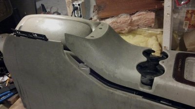

heres the eski console painted trim same color as truck
and LEDs in the dash

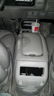

bad looking console,the bose sub,i put rca's in that rear
piece to hook up the wii game. more pics:Caffeine:
