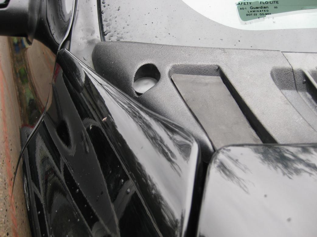

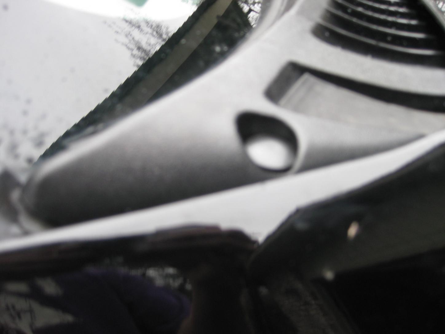

alright, heres the pics of my new antenna status.. I went to the hardware and found a rubber grommet and plastic cap that fit perfectly in the antenna spot. Pretty clean looking now :)

haha damn... sorry about that... but as far as reception goes I don't even notice a difference. i tucked the antenna alongside the rubber against the inside of the fender and then the tip into one of the two holes on the hood bump stop rubber piece.... Hope that helps a little

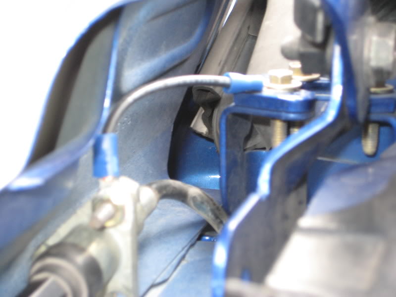

If you reception isn't that good, try grounding the antenna. Like below:
SMART!!! TRYING THIS SOON
