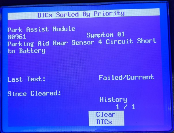

I had the Service Park Assist advisory appear on the DIC, so I got out my Tech 2 and started troubleshooting. This is the screen that I saw on the Tech 2 during the troubleshooting process.
I consulted with AllData to find out which park assist sensor was #4, and luckily, it was the right rear sensor, one of the easy ones to get my hands onto. I ordered a new sensor from GMPartsDirect, and made the easy replacement.
I figure that the Tech 2 just paid for itself AGAIN, by enabling me to troubleshoot and successfully fix the issue myself.
