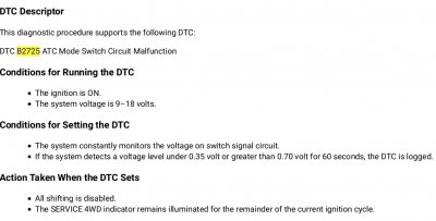

Ooookay so combining the lack of back light with throwing the code, and knowing the conditions for the code, I'm left with one of a couple options (I think, someone correct me if I'm wrong please help this is a cry for help)
1. There's an issue with supply voltage to the switch. I don't believe it to be ground related as ground for the switch, based on my understanding of how it's wired, wouldn't affect the output signal which is the condition for setting the code. This bit I'd need some knowledgeable folks who know where the power supply comes from, where the wire runs, and any pinch points
2. A fault in the power supply feed internal to the switch itself.
Both of these are difficult to test being that I can't seem to replicate the issue on a consistent basis. So this would be a case of inspecting what I can and seeing if there's anything obvious, or wait until it gets worse and I can replicate the problem to appropriately determine the fix
Any input /help here would be appreciated. This one's kicking my ass

I won't be much help on this as I've not done any related troubleshooting and have never had that code, but I'd be inclined to throw a UPull or cheap switch at it (after testing it) to see what happens. From what I've read it's the switch a high percentage of the time. I'm not sure if the Tech 2 will read the ignition voltage, but I do know it will read the 5v from the ATCM under the dash.
I'm not good at reading wiring diagrams but it looks like the ignition voltage doesn't come from the ATCM. You probably knew that already.
Might also be a good idea to pull the ATCM out and clean the two connectors. Kind of a pain to get it out from under the dash, though.
