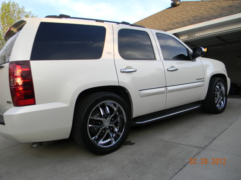

Got her done today. The kit was the one NorCalSS sells. I couldn't be happier. :)

I told the shop to put the spacer IN the rear and set to 2 3/4" but somehow the installer did not get the memo. :( I looked this morning and there is no spacer in. I need to call them this morning to make sure they did not toss it. In case I need it later. I think it looks good and the ride is not bad at all. I measured the drivers side only last night. I didn't take pre measurements but I know it looked like a 4x4 before. :D
LF = 33 15/16"
LR = 34 7/16"
Basically the rear is about 1/2" higher than the front. Sorry my pic kind of sux but that was all I could take last night. I need to take one on a level surface.

On a side note: I have brand new 305/40/22 tires and the front tires rub at full lock. I need to trim the plastic piece before I tear it all up. But the truck does look 10x better lowered.

I knew you'd like it, Roli. Looks awesome!

It does but I think it is a little low in the rear. I need to put the spacers in.
Roli -- I think I answered your email earlier with the idea you needed to PULL the spacer. Whoops! Anyway, the process is the same: droop the rear axel enough to make the springs completely loose in their perches, enough to stuff the spacer under them...

Looks great, but all that work and we get one pic? Come on bro.........LOL :D

Rain or shine, Roli! Get it done! Park it in front of the house, and take a pic from your living room if you have to. More pics!!

When it rains my ass stays indoors and she stays in the garage. :D Haha!!

Roli -- What's your ground-to-fender measurement in the rear (without the spacer in)? And is there one height when the rear hasn't aired up, and another height after it airs up?
