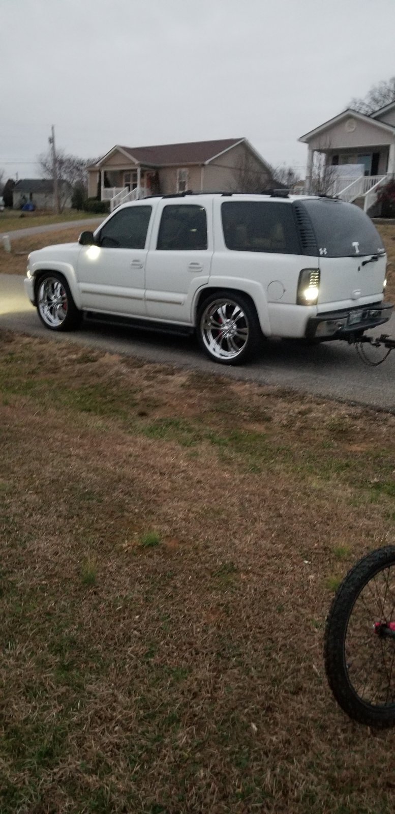

Another pic. Mcgaughys spindles stock keys turned down crown 4 inch drop coil. spohn panhard. djm rear kit with end links. Beltech sp shocks

So are you 3/4 drop now? You gotta give us better pics of that ride.

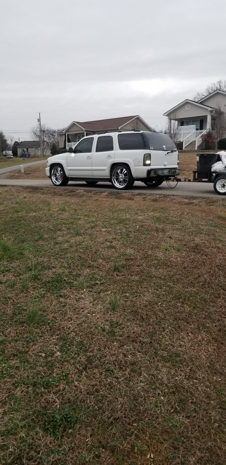

Nice stance, Brandon. How's the ride? Clearance issues?
And it only rubs when turning into a driveway or something not level. Or in the front at full lock on the plastic. It use to rub in the back going around corners until I installed the spohn panhard
Yea somewhere in there 2 inch mcgaughys spindles with stock keys turned all way down an 4 inch coils in rear. I'm bout to go lower. I've had mcgaughys coils to an it didnt lower it enough. I also had keys in the front before the spindles

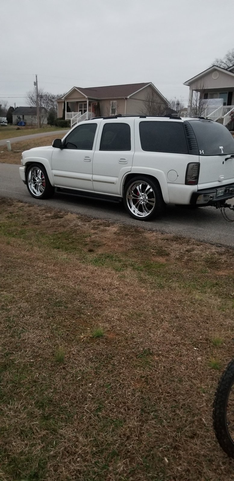

What did you tell me your fender measurements were at this time? I'm sitting at 33.5 in front and 34.5 in rear and I want to go another inch down.
