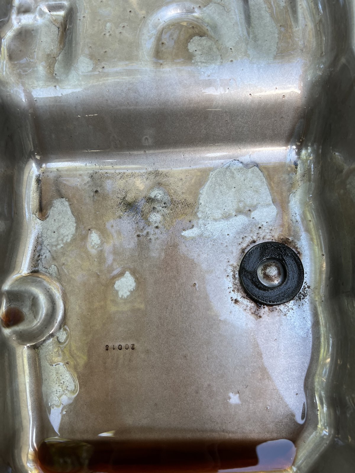

At this point, I'm not sure I'm ready to give up on the tranny. I'm thinking about pulling the pan and seeing what it looks like and what new fluid does. Would it be worth it to pull the tranny and just replace the torque converter? It hasn't been that many miles that it started having notable issues (less than 100)

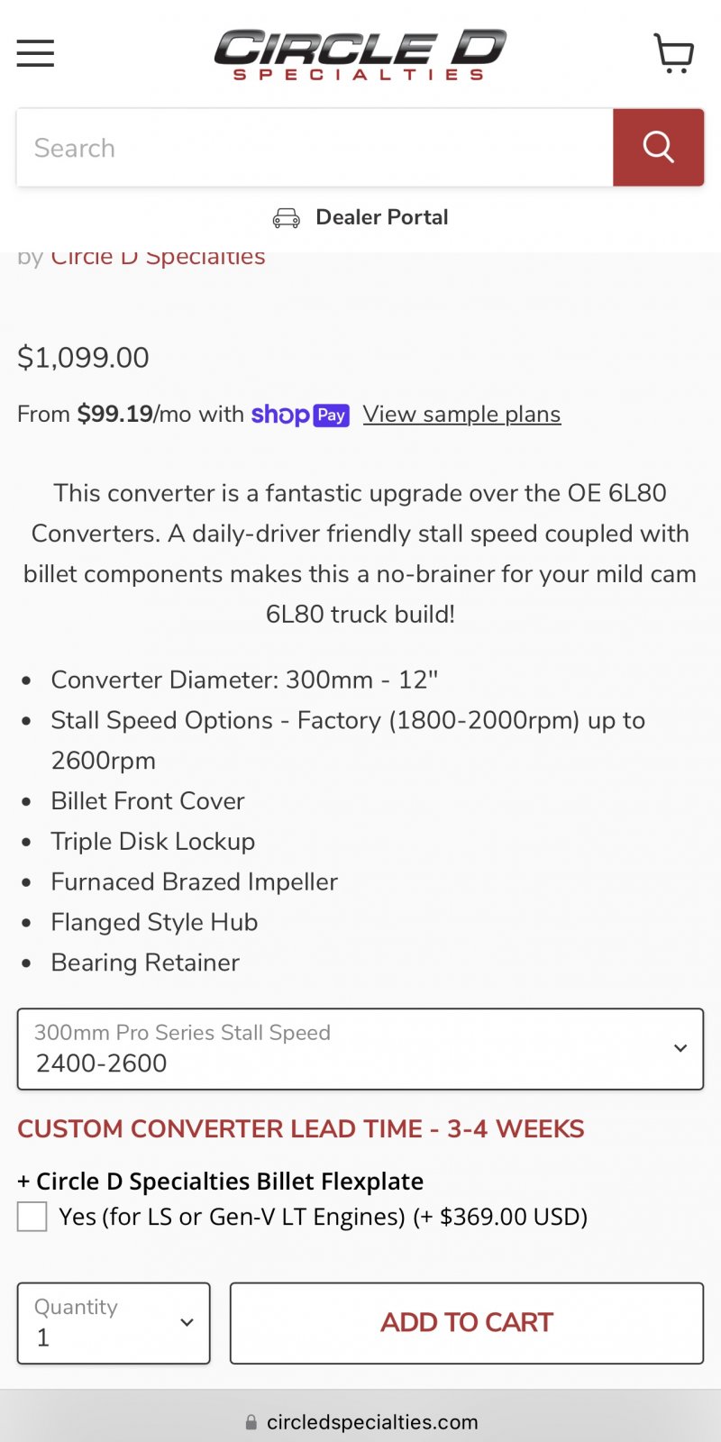

Yes, if that's the original JMBX factory converter, dump it and purchase an upgraded converter w/a converter clutch that's at least .050" thick. Also consider a billet cover if you're doing a lot of towing or otherwise live in a very hot, arid climate that sees temps north of 100 degrees. Pull the pan and take a look...If you see fine silvery looking material, that's converter..if you see small chunks of clutch material, that's likely converter clutch. If so (or if the fluid is really black and lots of clutch material on the bottom of the pan), I'd overhaul it while it's out for the rear main seal.
