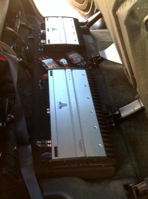

Build yourself an amp rack out of 3/4 MDF. Then you can mount it to the seat frame itself and then mount your amp. I'll post up some pictures of my setup later.
---------- Post added at 02:34 PM ---------- Previous post was at 01:16 PM ----------
Got those picture for you. I still haven't had time to pull out the board and the amp and wrap it in matching carpet yet. Also, I used 2 SS Allen bolts to mount it to the seat frame. I did those so I could have the ease of removing and installing this rack. I also counter sunk them so they didn't stick up.

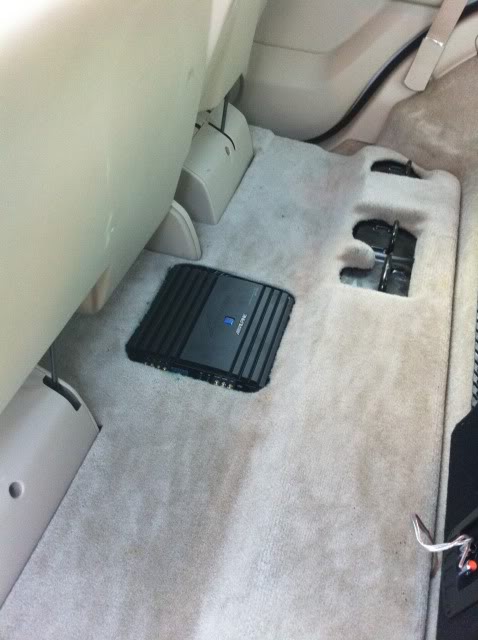

For mine I just pulled out the beauty board under the second row 60/40 and mounted my amps underneath, then cut holes in the beauty board where the amps are for ventilation and looks.
This is the same thing I did, I have a MTX TC301 - class D 300W mono block pushing a JL Audio CS110TG-W1v2 and I have no problems.

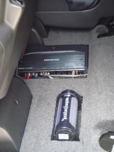

From my experience a Rockford T40001bd or T8004 does not fit underneath the seats I had a false floor made in the cargo area only place for them to fit. Also I added a Rockford 100 farad and 50 farad capacitor into the driver side rear panel. dispalying voltage of one where the door for accessories was.
