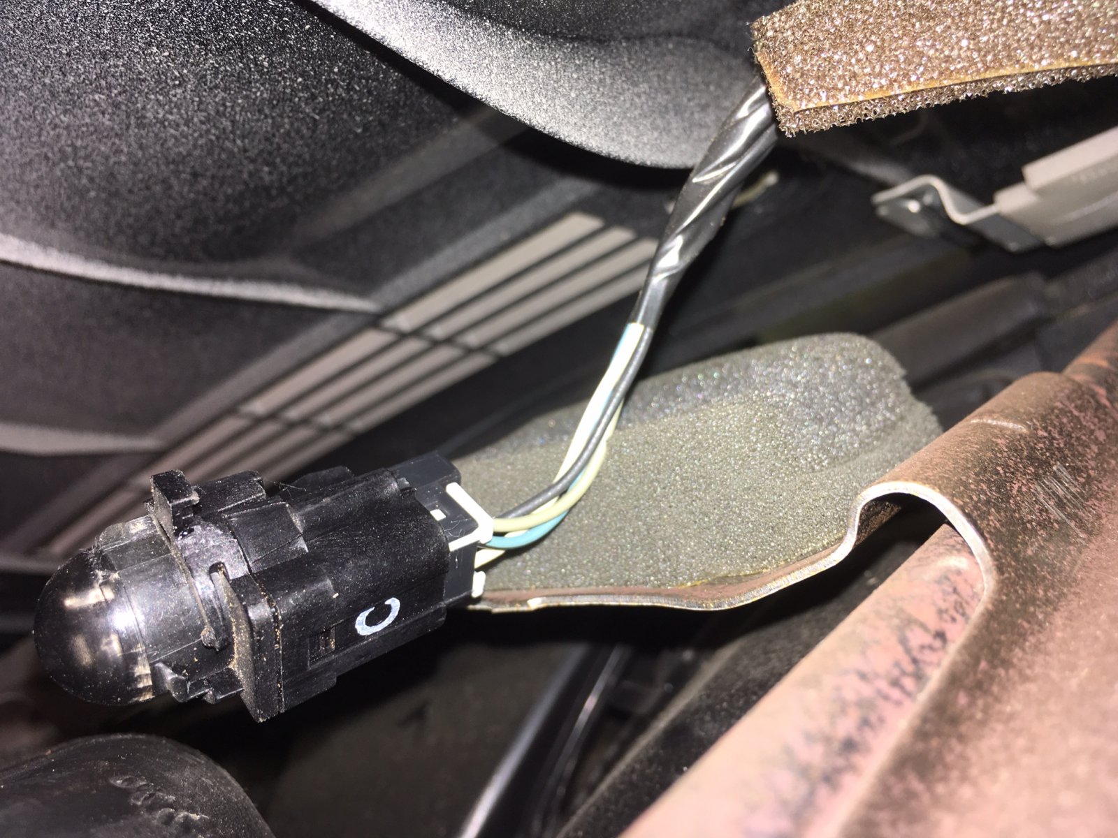

I pulled the dash for a look at the sensor plug and wires. This version of sensor supports both lighting and HVAC (3709-07164055) and has four wires (see photo: black, light green, blue/black strip, off white) Again, easy enough to splice resistor here :)

Yes it is a combo Sunload Sensor + Ambient Light Sensor Signal which is why there are more than just two wires I/O. Power switch toggle would be too easy? I took a gamble that the black wire (ground) and white was the signal back BCM for the light sensor, turns out a good guess on my part.

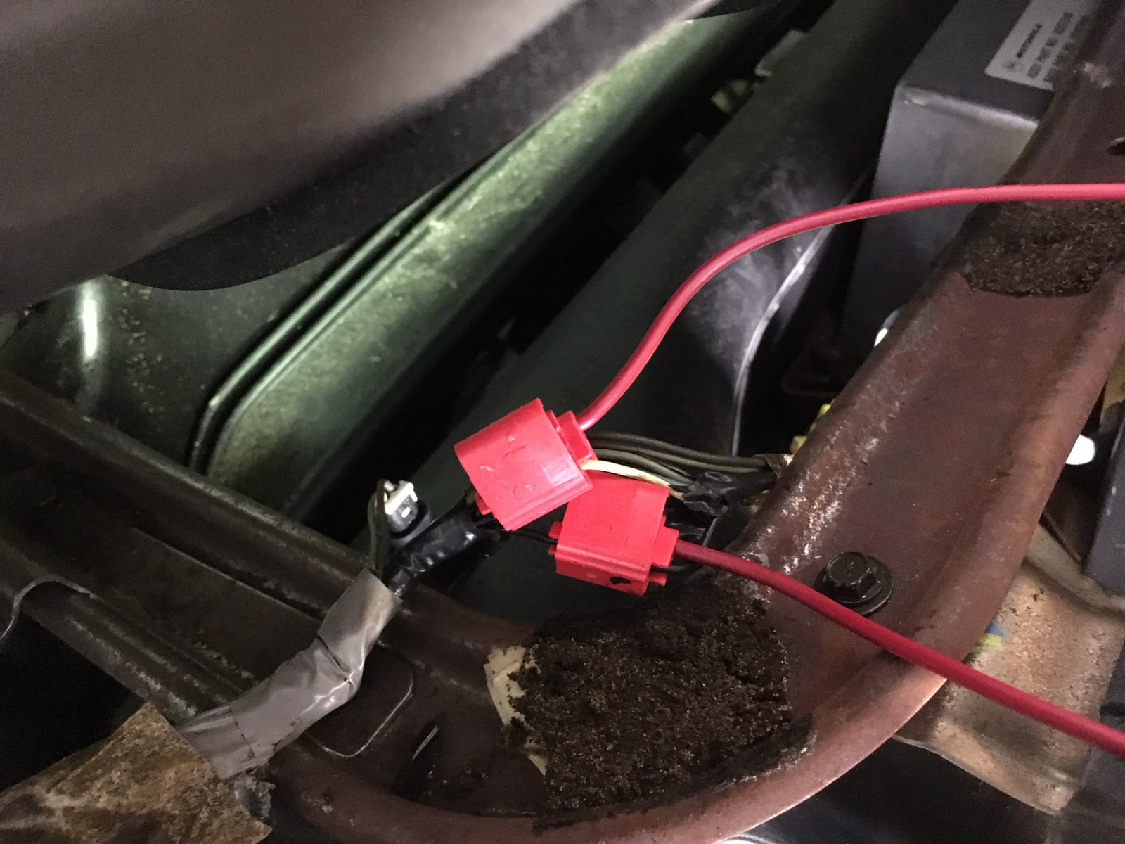

Never mind all the BCM garbage above, I kind of solved this. Let me explain....
Since I already had the dash off to get a better look at the SENSOR, I went ahead and tapped the black (ground) and white (signal to BCM) wires that lead to it .

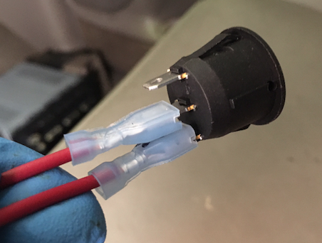

I could of just spliced in the resistor in but I added a toggle switch for greater control.
While not as 'easy' as splicing wires UNDER this works - taking the dash off isn't all the difficult anyway. (Plenty of youtube videos to help you.) Plus, I didn't figure out what wires under the dash were the right ones anyway.
Sensor:
Spliced in a wires (aka tap)
Not pictured is RESISTOR..
Then here is the toggle switch:
Best part, it works. I hope this helps someone else!
Finally, i think this is correct for the leads to/from the sensor:
Blue/BK - Driver Sunload Sensor Signal
Green - Passenger Sunload Sensor Signal
Black - Ground
White - Ambient Light Sensor Signal
