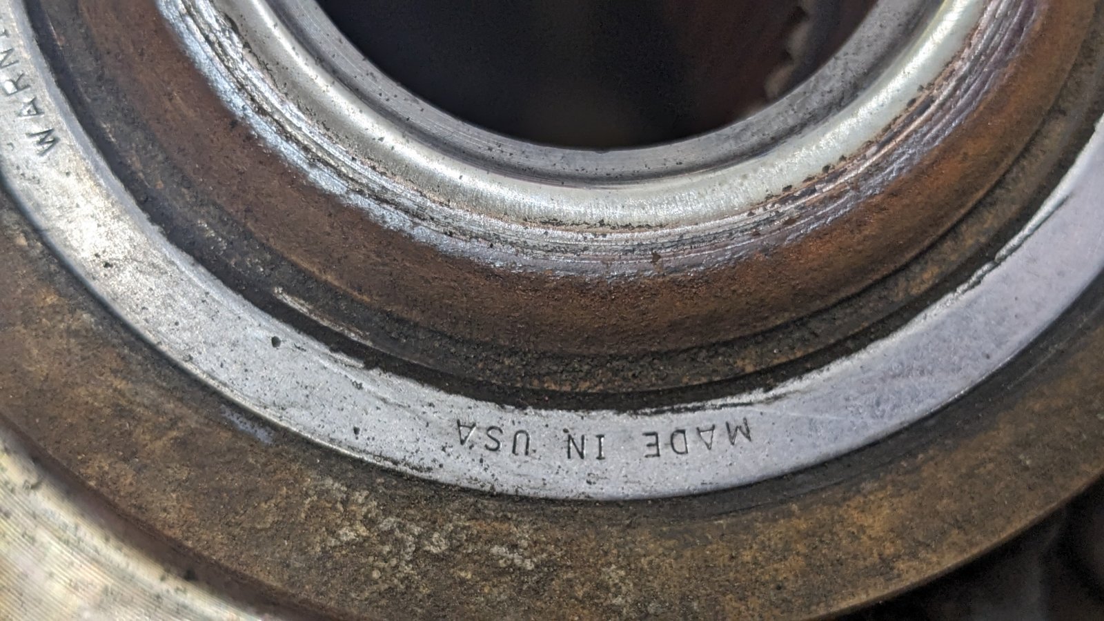

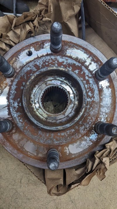

I bought these "oem" hubs for the awd denali about 4 years ago, they are genuine gm, made by iljin korea
currently have about 30k on them and they are fine
if you zoom in on the rockauto photo you can see it stamped iljin korea, same as mine
huh. I thought forsure my hub would be oem on that side. I haven't tossed it yet, went out and looked. no markings on the flange at all. flipped it over, knocked off some crude and bam.. timkin.
I got it at 135k, guess the oem didn't make it that long. all junk.
