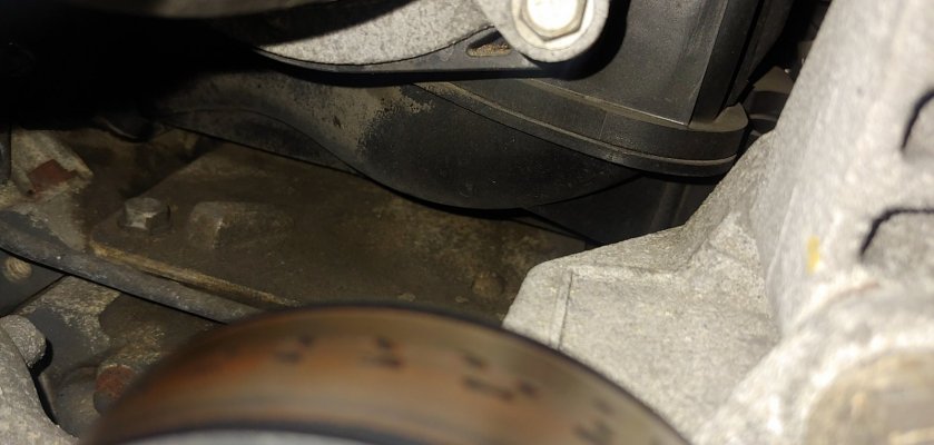

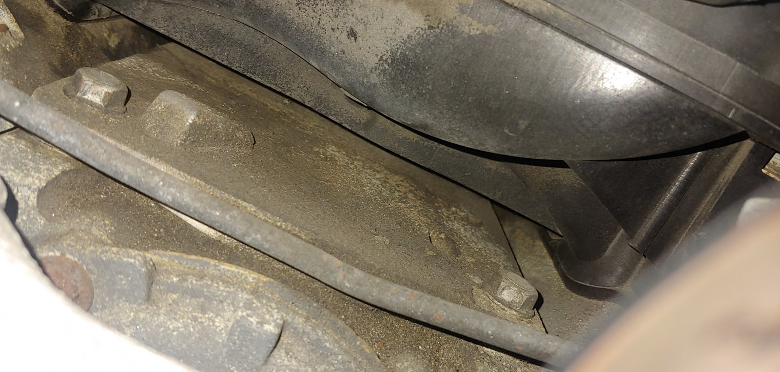

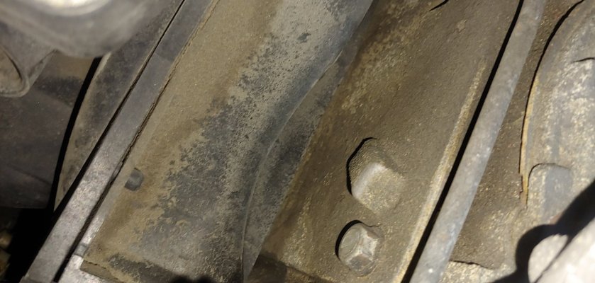

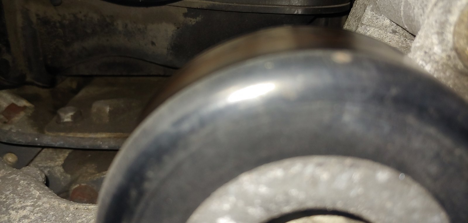

Ok, I have an update. First, I'm pretty sure I don't have a FM. The plate underneath the intake manifold doesn't look "lumpy". I posted a pic of the plate as best I could take. Next, I hooked up the smoke machine and I'm getting a ton of smoke coming out of my oil fill tube extension at the base word connects to the valve cover. This would explain all of the unmetered air coming in. So I'm guessing this is the cause of my misfires on bank 2. I have read that you can remove the extension in place the filler kept directly onto the valve cover and have no issues ever again. It kind of sucks that you have to remove the valve cover just to replace the tube. As soon as I started running the smoke through the intake tube, I started hearing that big hiss right away. Once the smoke reached the tube, I was relieved. Hopefully, eliminating this tube well forever solve this issue. So I guess it's time to go to work

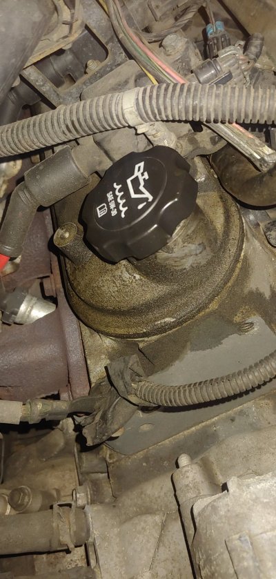

Popped that sucker right out! So far so good. Let's see what happens over the next few days.
Just found out my filler hose is not even attached, did your fix and going to test tomorrow as it's late here. Thanks for this documentation (Probably not the cause of my terrible p0300 tho, but I'll sleep in the hope tonight)
The filler necks on these SUCK. I bought brand new ones and they still wobble and leak. I just left it off and put the cap right on the cover like you have it. I have a funnel that fit's in that pocket perfectly when I have to add oil.
