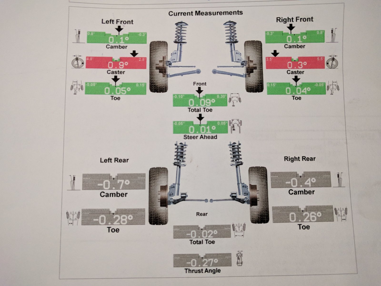

Had an alignment just before Halloween and after some hours behind the wheel I've noticed a straight line tracking, cornering and wandering to the right at times issue.
Dug out the alignment sheet and noticed the font left caster is .9* front left camber is .1*. Shouldn't these two be tighter spec?
I know what to expect out of mud tires and road grip wander but this feels straight line tracking issue. Wants to wander to the right at times and the steering wheel isn't self centering as expected.
Anyone know much on the topic?

Mine had the camber adjuster maxed out in the right side after this specific alignment and it tracked to the right pretty good due to bad toe before it. Caster was readjusted to a closer spec, and it tracked so much better, despite the camber being off on the right side. I don't know how a lift affects the entire geometry/adjusting procedure or how it reacts to it, but it looks like it could be adjusted to a more reasonable spec as it sits it's out of spec, unless the guy there told you some reason as to why it cant be brought to spec. Sometimes these guys can half-ass things, and don't give two cents about what it looks as long as it is within the ballpark. I had a terrible experience at the first shop I took my truck to and they kept having me back. Caster affects the return to center so being off I would imagine it would cause you to end up shifting to whatever side has more bias, or at least that's my theory am no expert. This is how mine looked before final adjustment and it tracked right, I had one more final alignment after this one and it got things to spec after new hardware for both camber and caster was installed. https://i.postimg.cc/zBBj93ZF/P-20180819-164634-1.jpg

Here I lied this was another terrible alignment job, all they cared was ballpark numbers and called it aligned, note I dont know how tire size or different trims affect the alignment on these trucks as they are about the same, but they entered the wrong vehicle despite that being like my third time in there, here they used a 16" wheeled 4x4 and not 17"s which my truck came with. If I recall correctly this pulled right after a few feet and I had to readjust which pissed me off pretty quick.
https://i.postimg.cc/024mWZcj/P-20181130-001505-p.jpg

Thanks Erick. Would you say that with the numbers I'm looking at I'll need the career and camber closer? I don't like driving something that feels out of control. it has better control before with my old front end

Honestly, the camber is pretty spot on. Camber and toe are the 2 big ones when it comes to tire wear, even though the toe is in spec it isn't the same in both sides which it should. The biggest problem with your alignment is the caster which is way off out of spec, I don't know how they managed to not leave the toe the same though, Out of all the shady places I've been to they've never managed to screw that one up. if they return it with the caster out of spec in the red zone either negative or positive ask why that's happening. I would be curious to know, For me you can see the guy that did mine provided a reason as to why the camber couldn't be brought to spec, which was maxed out cam plate adjustment. best of luck:2cents:
