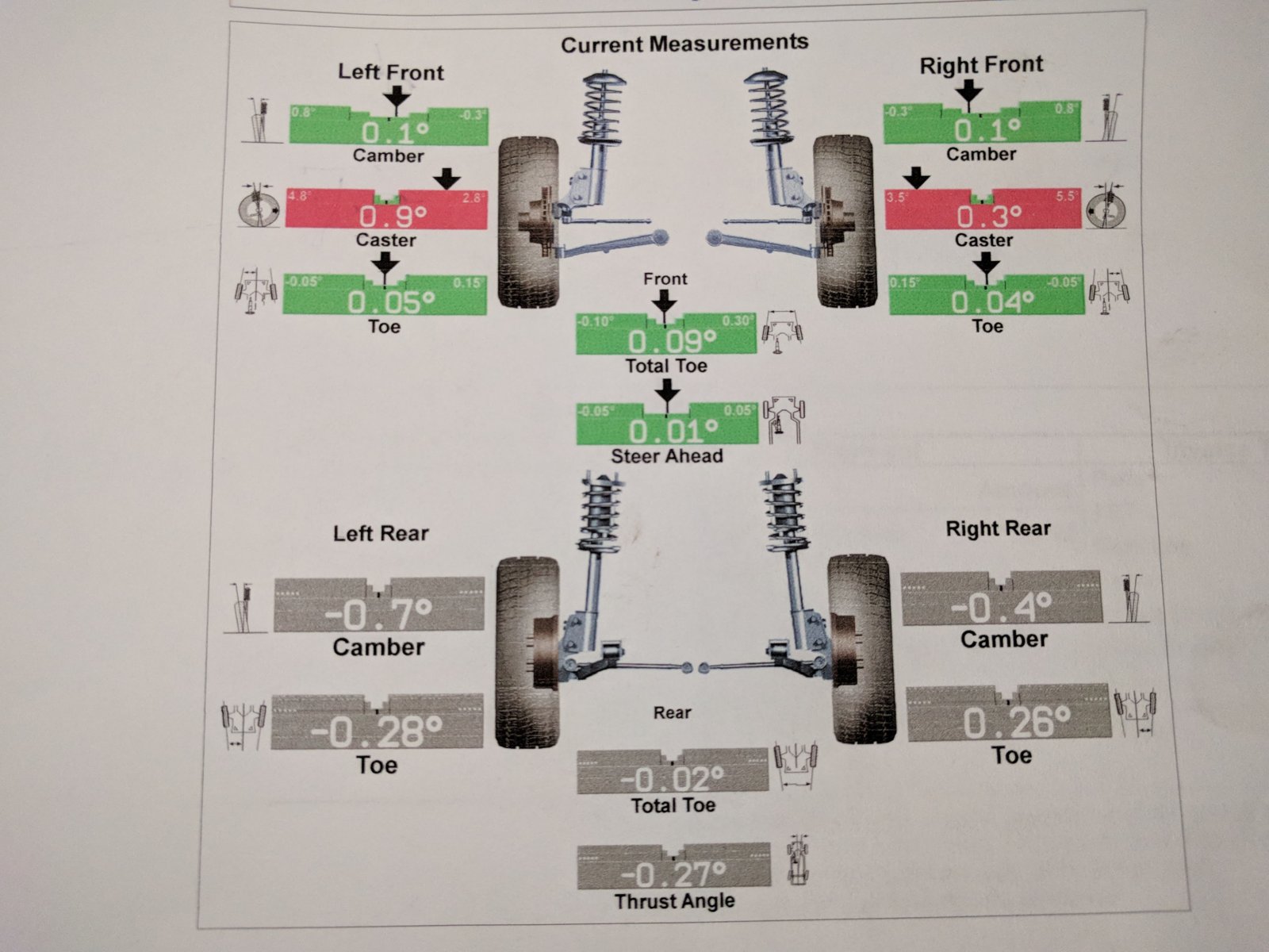

Had an alignment just before Halloween and after some hours behind the wheel I've noticed a straight line tracking, cornering and wandering to the right at times issue.
Dug out the alignment sheet and noticed the font left caster is .9* front left camber is .1*. Shouldn't these two be tighter spec?
I know what to expect out of mud tires and road grip wander but this feels straight line tracking issue. Wants to wander to the right at times and the steering wheel isn't self centering as expected.
Anyone know much on the topic?
