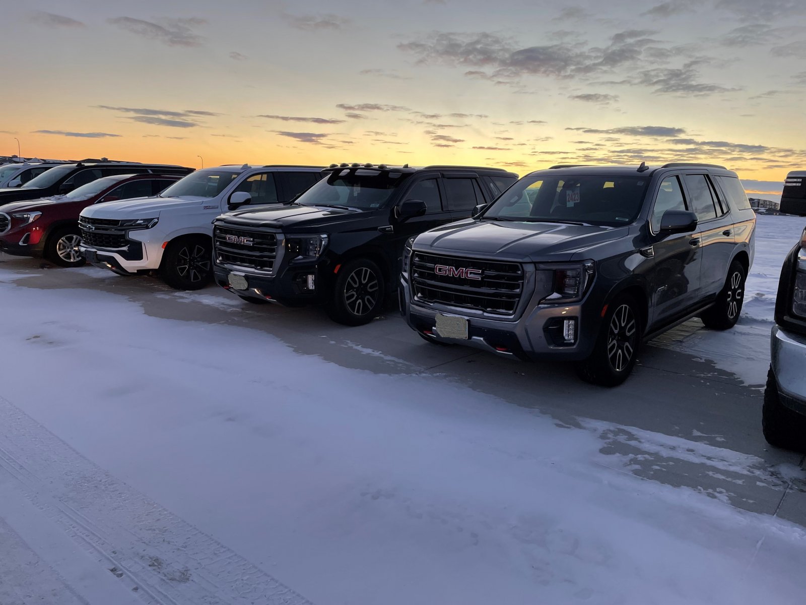

Agreed - not sure that I have seen another one like that - I originally posted the pic. My (now former) Yukon is the one to the right. I drove by the lot this evening - two more added to the waiting-for-parts pile - five weeks and counting for repair parts. I sold mine back to a GM dealer last week. It is an interesting world for sure - drove it a year and it was still worth more than what I paid (including the lost sales tax). Now, I am patiently waiting to see whether German engineering can live up to its reputation (I know that is naive). Anyone know if there’s a board for MB GLS450’s!?! Take care.

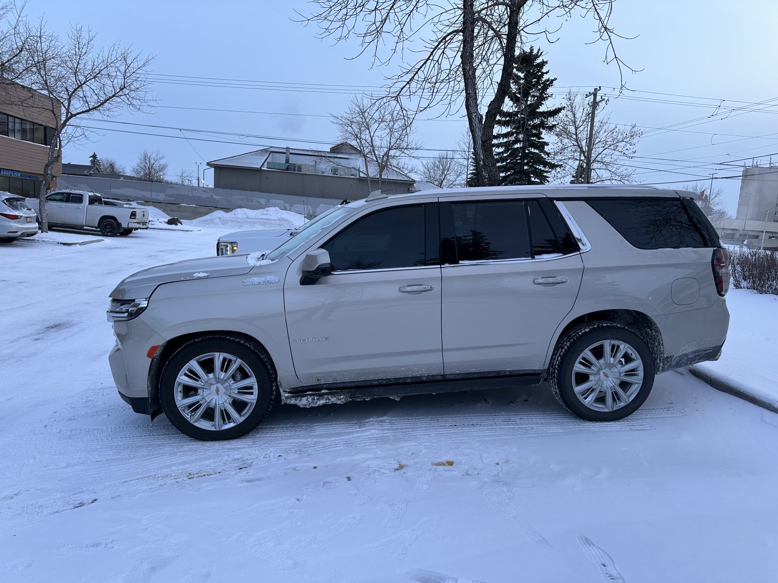

We have a 2023 Tahoe High Country with 1500 miles. It was really cold here last week (-35 degrees Celcius). 2 mornings in a row we came out to the vehicle with the front end very low compared to the rear. "Service Leveling System" and 'Leveling System Unavailable" notifications in the DIC, ride height controls did not work. Photo attached.
We were having an occasional issue 2 weeks prior when it was below 0 degrees Celcius prior to the cold snap, same notifications in the DIC and ride controls not working. But the vehicle stayed level, it was just stuck at the exit ride height. We disabled the easy exit/entrance and issue went away until this week.
Unhooking battery for 2-3 minutes reset the issue, then we could drive normally. Its at the dealership now, picking up tomorrow. They are replacing a module.
