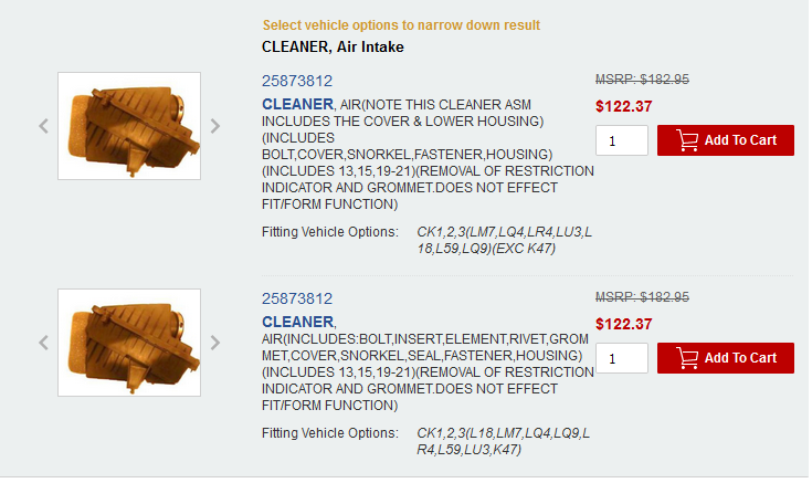

Kind of odd that the same part number appears to fit different engines, with some overlap between engine codes (searched a 2003 Tahoe RWD):
