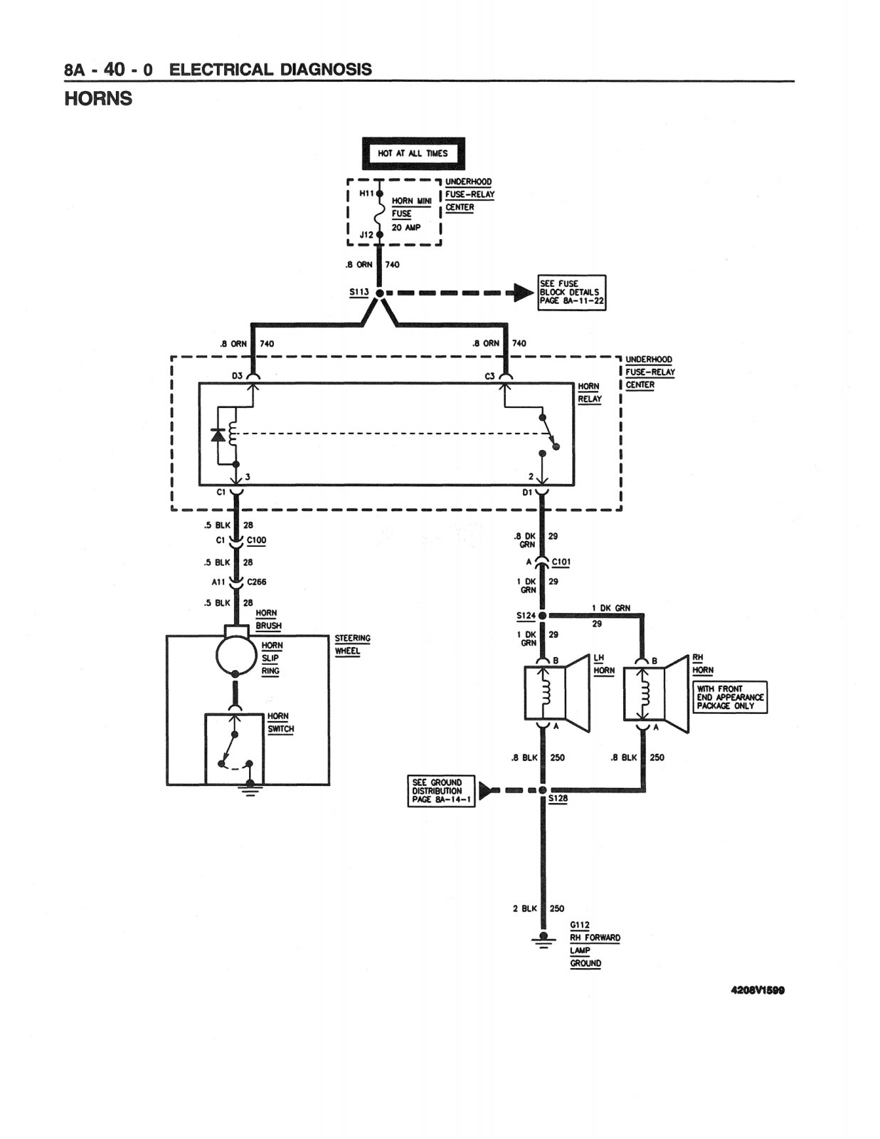

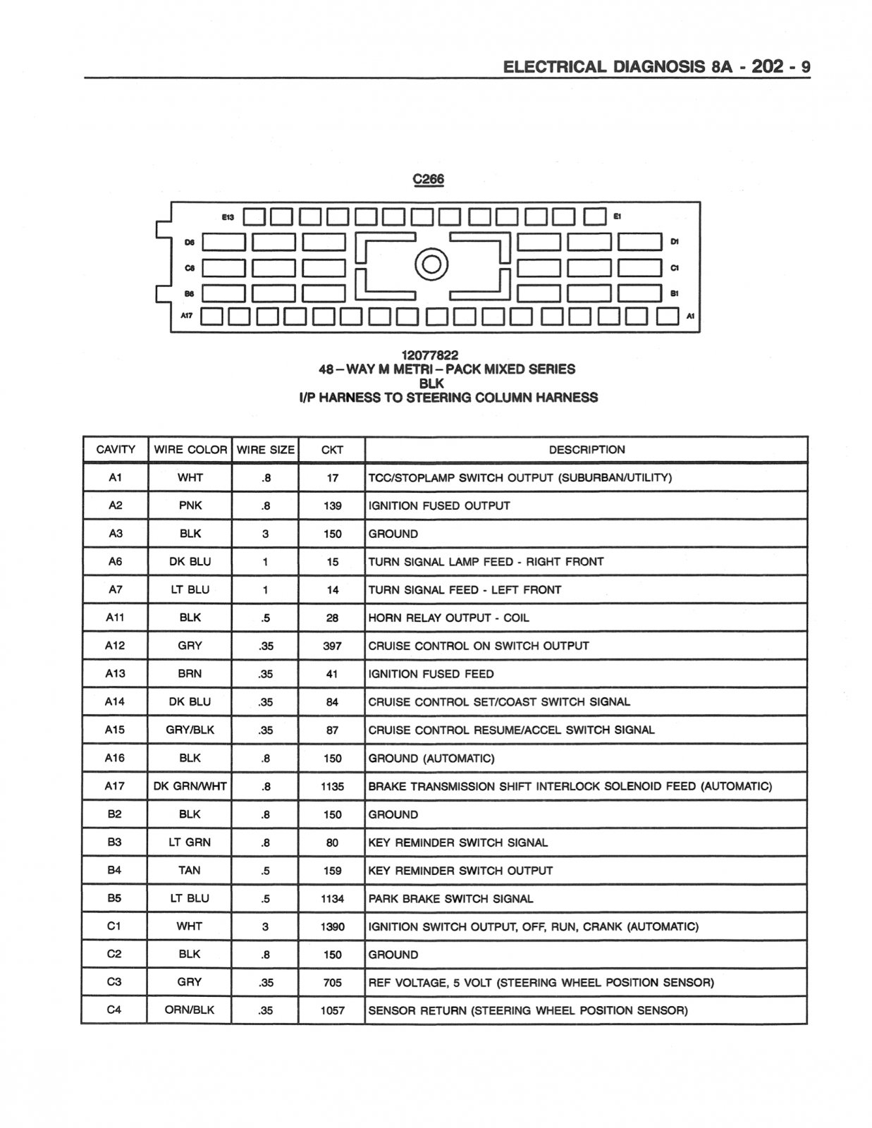

Sincerely appreciate your reply. For now, I'm going to leave the current clockspring in so the airbag will continue to function. I'm just going to bypass the steering wheel's horn button.
At the moment I'm trying to locate which wire exists the steering wheel and sends that momentary negative current to the horn relay...

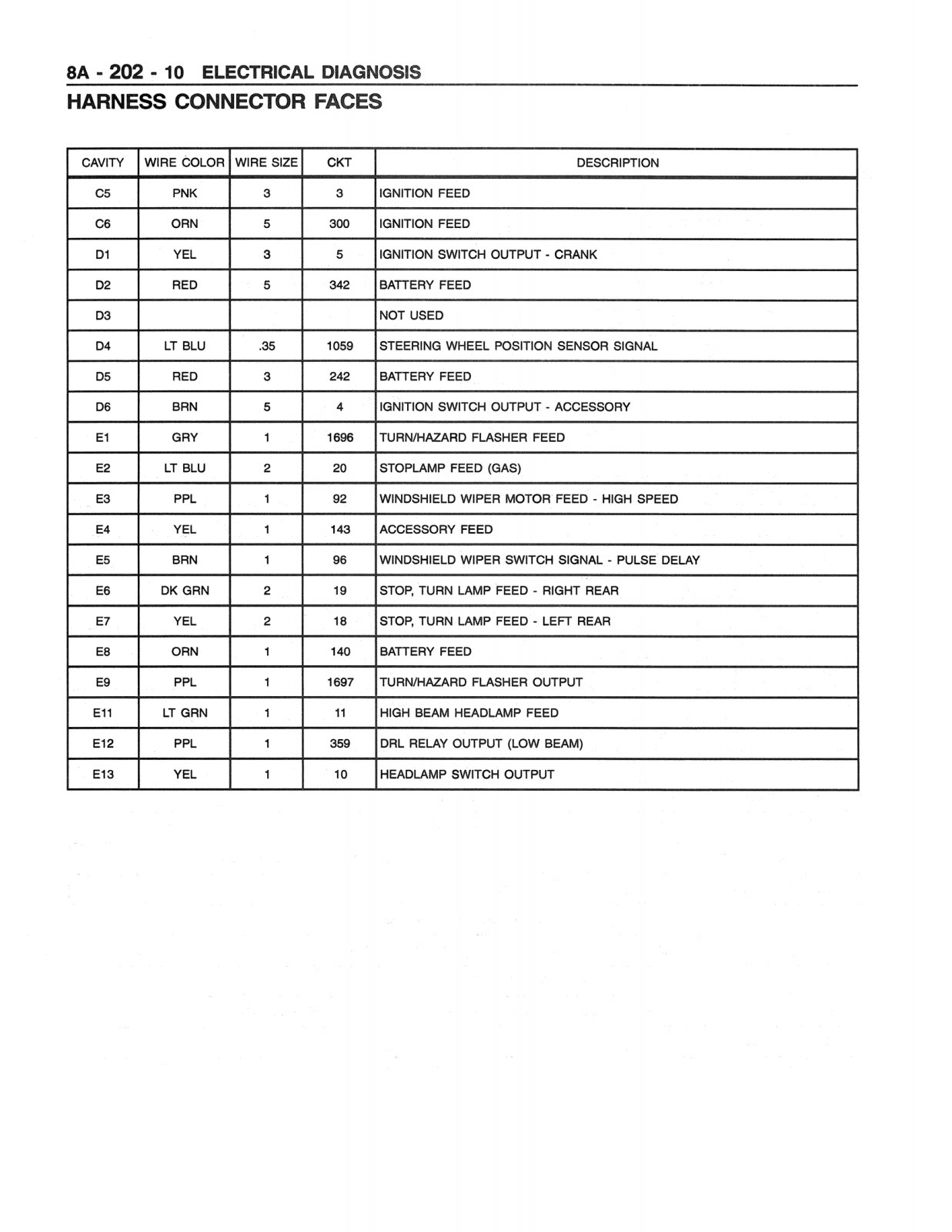

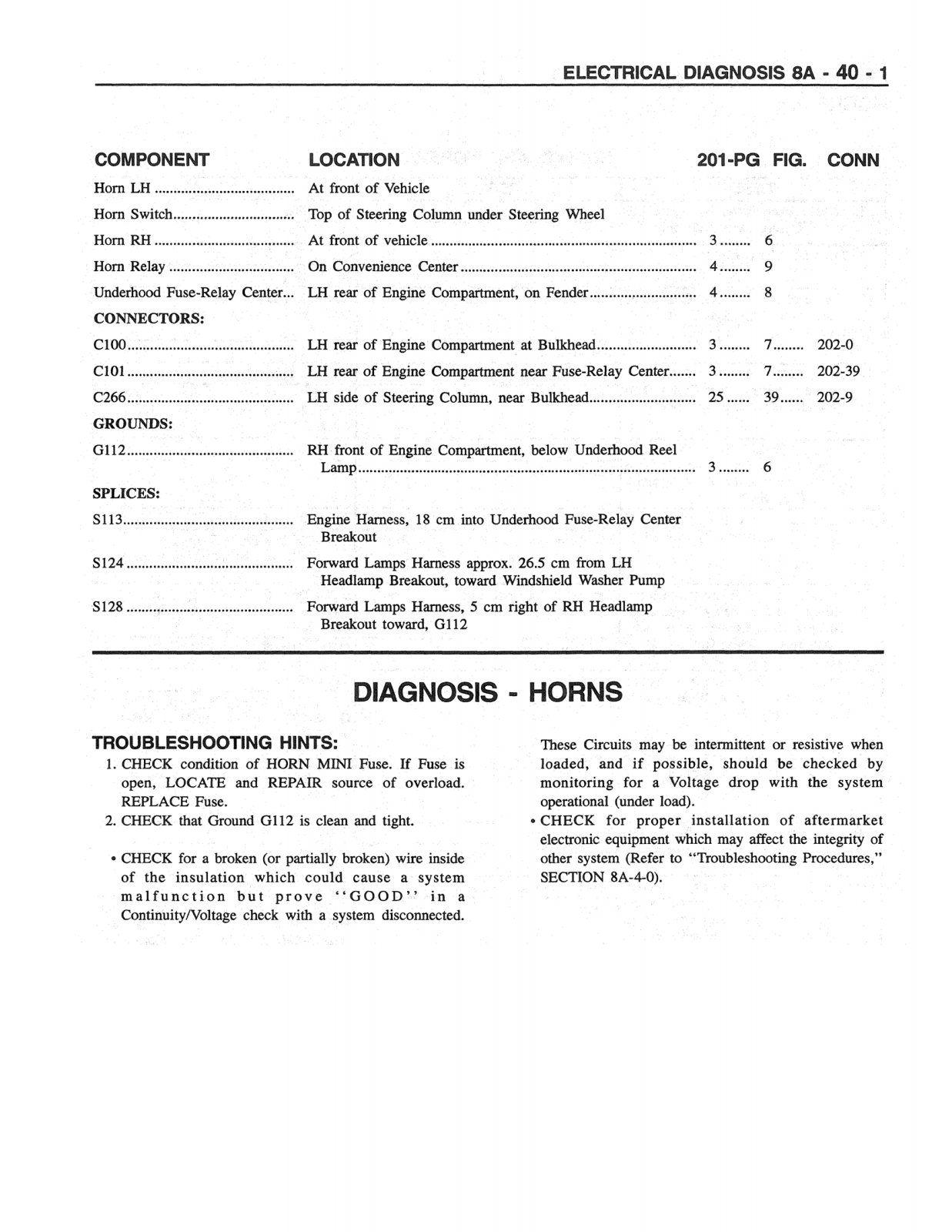

Here is the diagram from the 1997 manual. The PDF of the complete set can be downloaded here:
S
Sptwall
May 22, 2023
33
38
East302 you are The Man! I just read your message and saw the wiring diagram you uploaded. That is exactly what I needed. I will be putting in a bypass button this weekend. Good of you to share that wiring manual; much appreciated.
