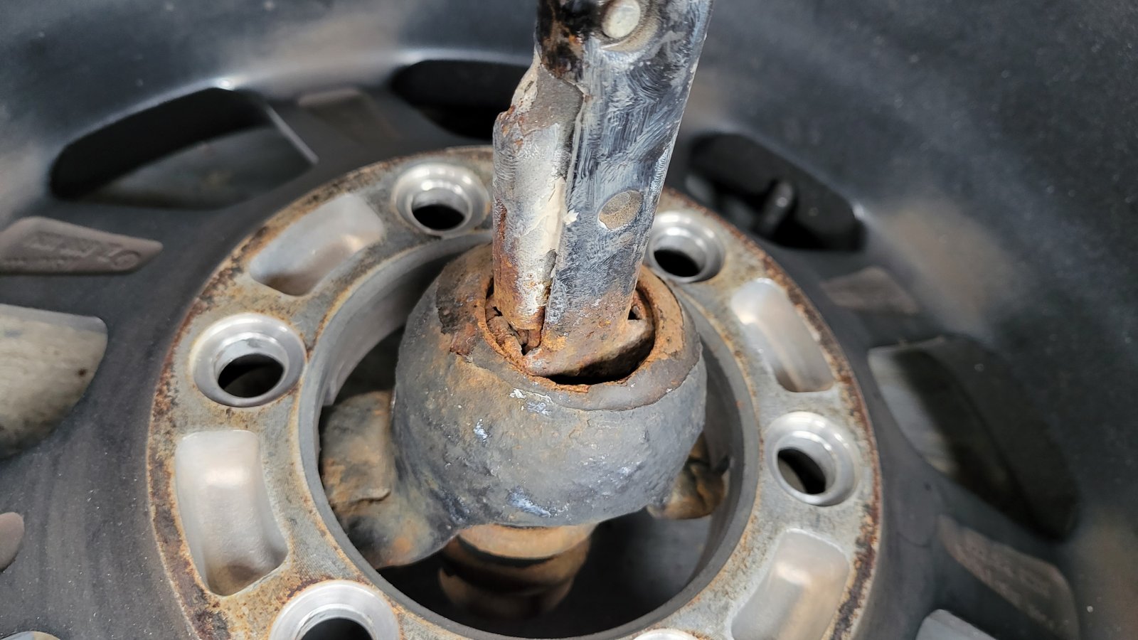

Ran into this issue, Had to cut the spare from my Yukon XL 2500 4x4. When I got a replacement from a Suburban 1500 come to find out the the 4x4 center bore is bigger then 2wd model. Made a ugly repair due to camping inside the Yukon and spare takes up a lot of room. Look for ones with wider lift point.
Another thing If you have the chassis with the back 10 gallon tank you will need to buy the shorter one.

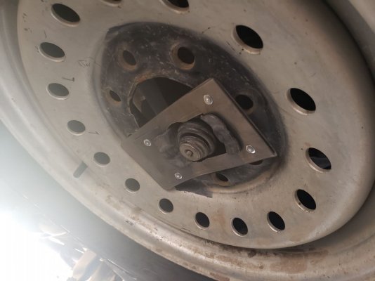

That's a great idea too. I just wonder how you got it on there. Did you rivet it together after putting the claw through it?
Shackman7878
Oct 17, 2020
142
184
San Bernardino
Used rivets do not have a welder at this time.
Black is the claw. Red is plate cut slightly smaller than the claw thread it one side then the other,
Gray is the squares I cut and riveted on each side behind the edges of the claw and give it some strength.
You will need to measure the hub opening and from one lug hole to the other and cut steel to fit and rounded the edges
Made this with leftover steel in my garage.
Part number 22968178 or Doman 92451. Amazon had aftermarket ones but you call on using them. Highly recommend using a Silicone or graphite spray inside the hoist itself and running it up and down a couple times.
If you buy the Doman one, get it from Local auto part store Autozone Etc with a lifetime warranty behind it.
As part of my spare tire kit I put a hacksaw/heavy duty lineman pliers/Small bolt cutters in there in case the hoist gets jammed and I have to cut the cable to drop the spare.
