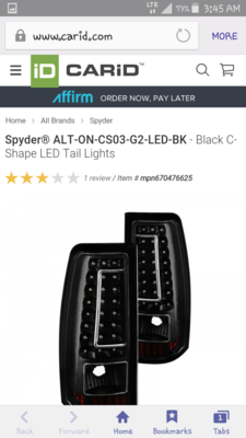

I also hated my stock tails... you couldn't see anything behind you when it was in reverse.
I bought a set of these on ebay for $130:
https://www.carid.com/spyder/red-eu...d00-led-rc.html?singleid=145252411&url=938261
It has a similar look to the ones you posted, but in LED.
They are styled in a way that makes it look (to me anyway) like what GM might have put on the truck if they did LEDs.
I like how the entire thing lights up for parking lights (more light so "blind" people notice you), but it still has separate brake and turn sections of the lamp.

Those will look nice. Similar to my LED Spyder versions with the JDM Astar reverse bulbs in there. Very bright behind even through the dark tint.
