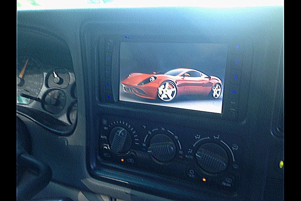

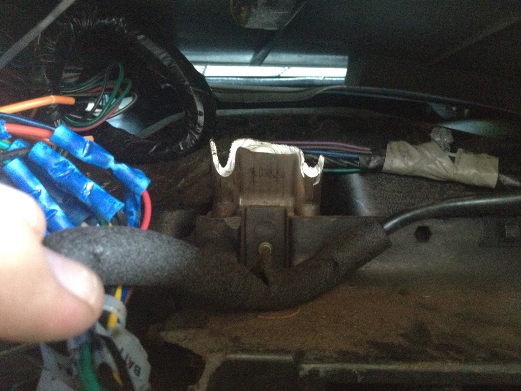

Here's the cut
Here's the finish
Very easy, very worth it..
The opening needs to be filed out some too for the larger face of the double din

Thanks and woah thats weird, I actually went ahead and did it without the pics early yesterday but I did not have to cut that at all. I had a weird setup i guess where the only thing blocking it was some black plastics in the radio shell (two small black triangles on either side of and a little hump), I was able to keep the whole rear metal brace. I don't know if its because my tahoe is weird or my radio was small but I got to pull it out again later anyways so ill post pics for the curious

Yeah I guess you got lucky lol.. My double din was solid metal all the way back and the bracket wouldnt let it go in the last inch.. But yeah the newer model has the true double din cd player and you can avoid this small headache! Thanks BTW!
---------- Post added at 01:49 PM ---------- Previous post was at 01:48 PM ----------
DCT, it's just a extra dash support I guess
