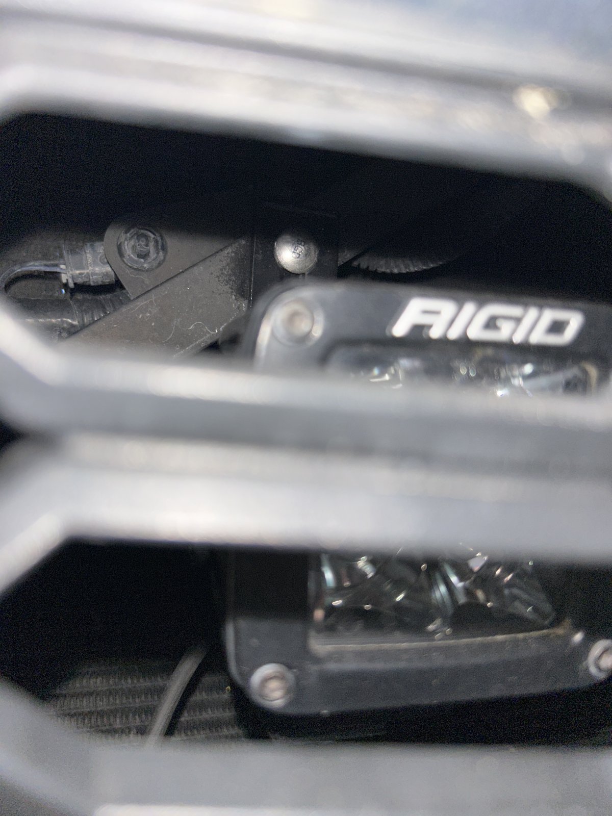

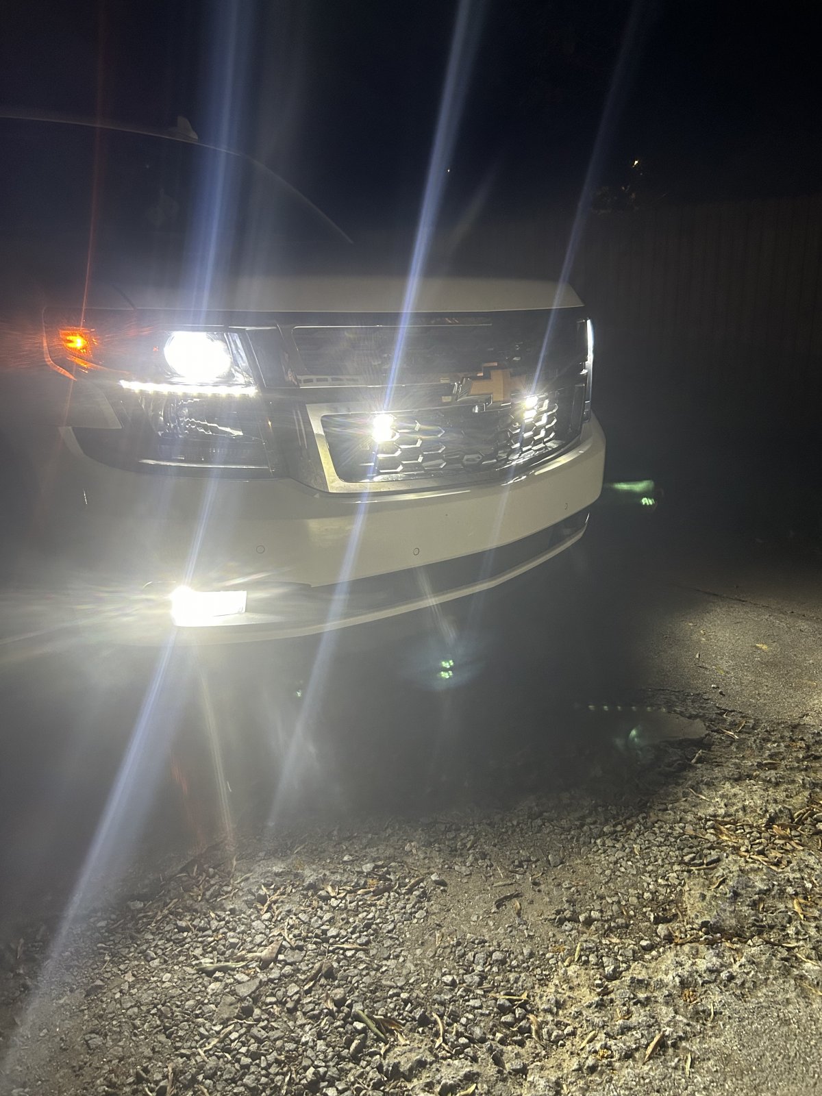

Side and rear? I don’t have anything but for front lighting I installed two Rigid fog lights that I also built a custom harness that connects them directly to the factory fog light switch. They sit behind the front grill.

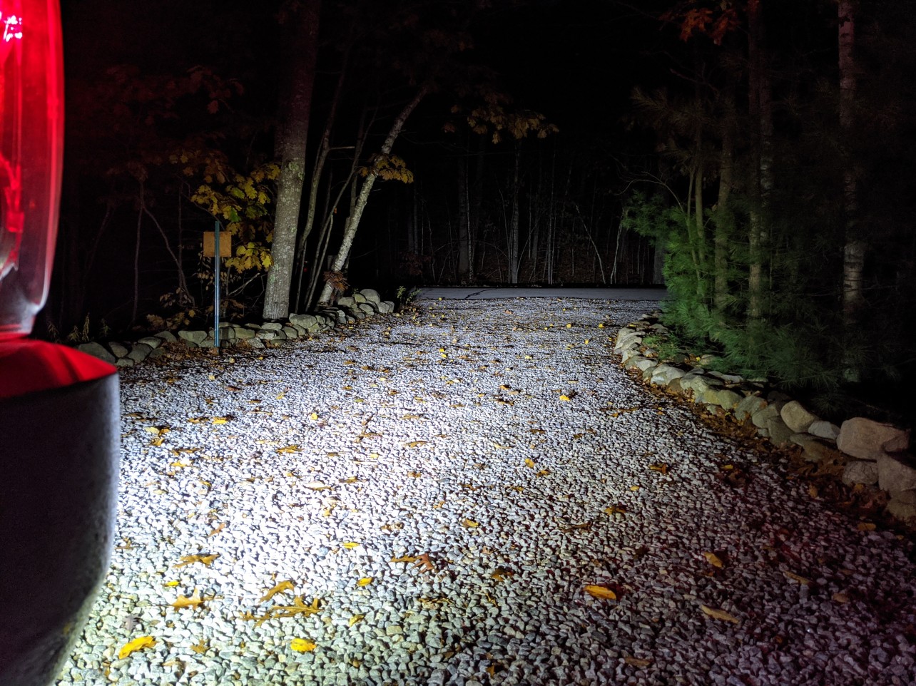

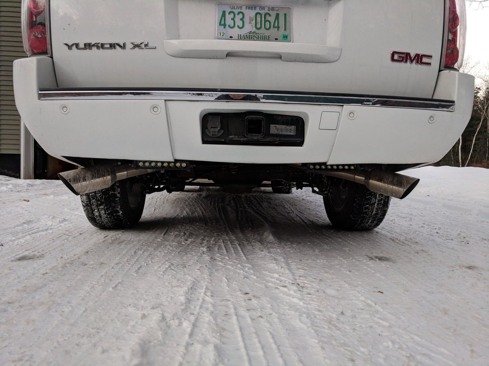

I put GTR Ultra 2 LEDs in the front, and I am happy with the extra illumination. They are expensive, but they are adjustable to obtain perfect light beam alignment, and they are warrantied for life.
I put 2 8" LED bars on the rear, since IMO the OEM backup lights are next to worthless. They are located under the bumper (pretty well protected against road hazards), and they are wired to light when shifting into reverse.
I love this idea! I forgot to mention that I have a bull bar on the front and mounted a light bar on it. These still definitely would help. How did you mount them?
That is incredible lighting! Do you have the link to where you got them?

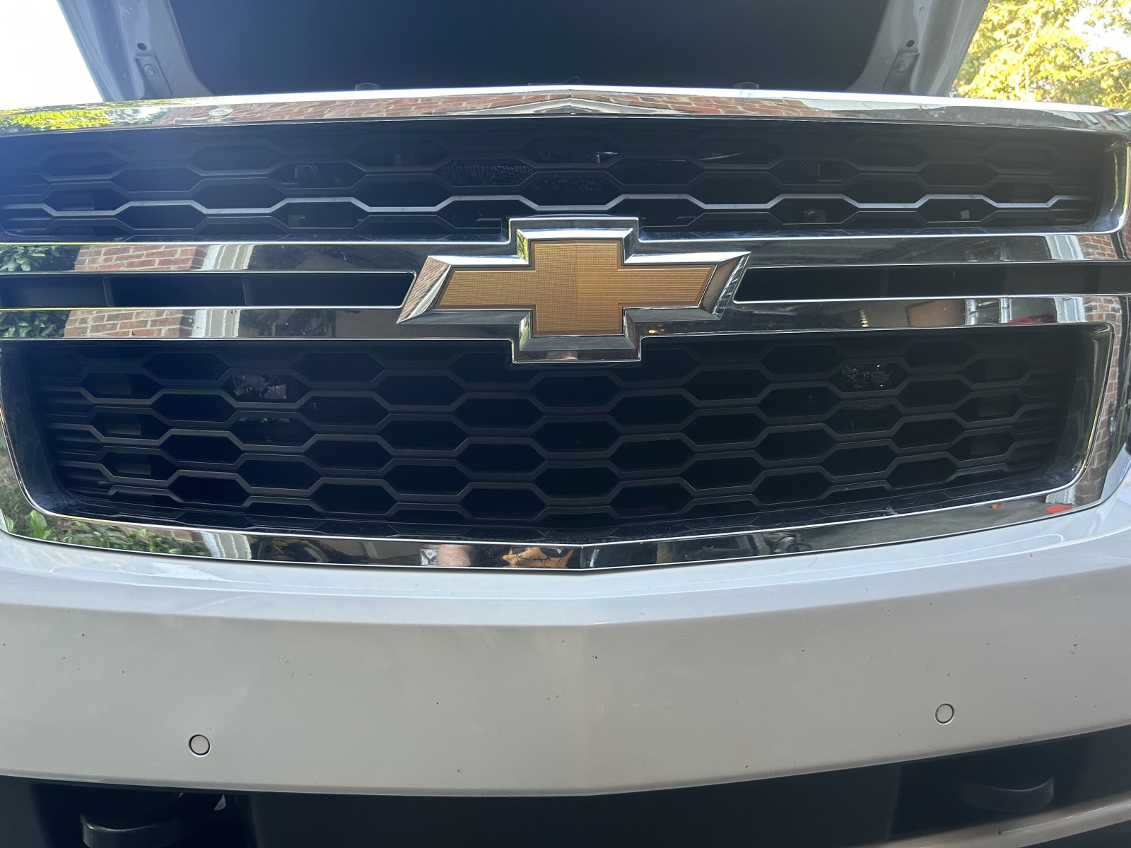

I had two leftover L-brackets from another project that I drilled two holes into the radiator support (I think that’s what it is at least) the. With a nut and bolt, mounted it up.
Not a great pic but you can see where I sprays a bit of black paint to seal it up after drilling.

Good luck! There should be PLENTY of room. There is gobs of space behind the grill.
They are Rough Country brand LED bars, which you should be able to easily find. I purchased them from my local audio dealer, who sells other items such as lighting, as a side business.

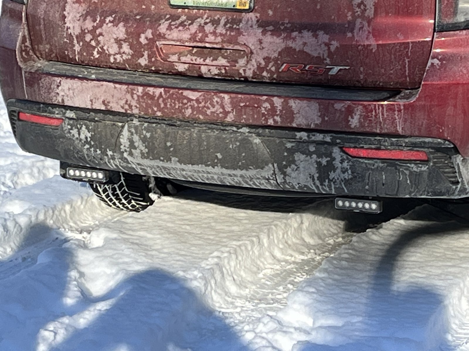

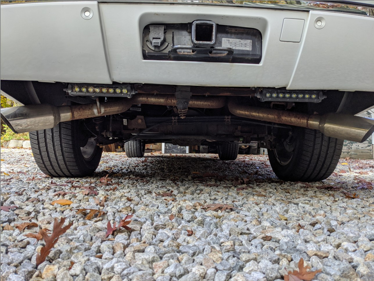

I agree with you on the backup lights, nearly useless…
I added these…. Super bright and not super visible….

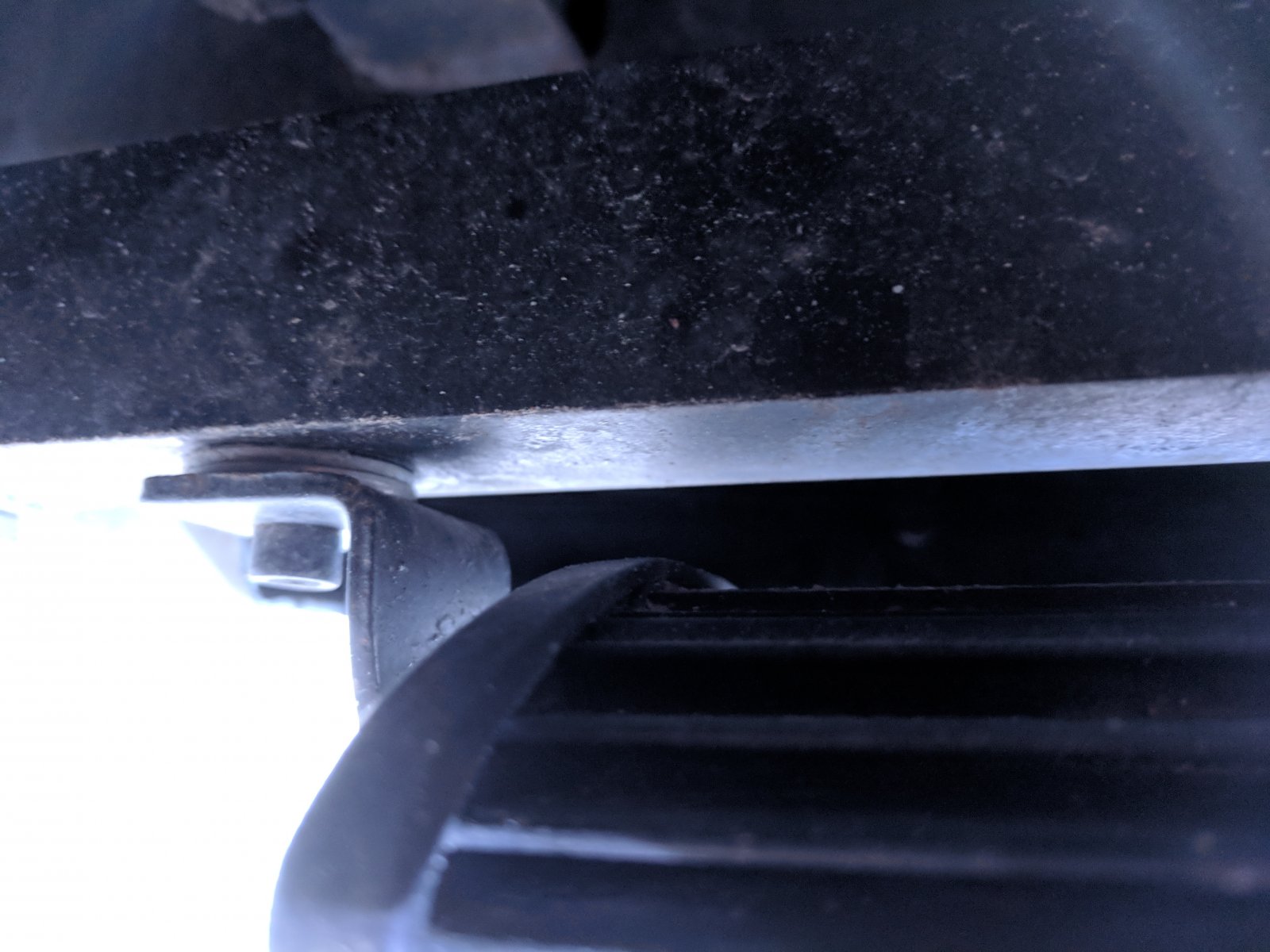

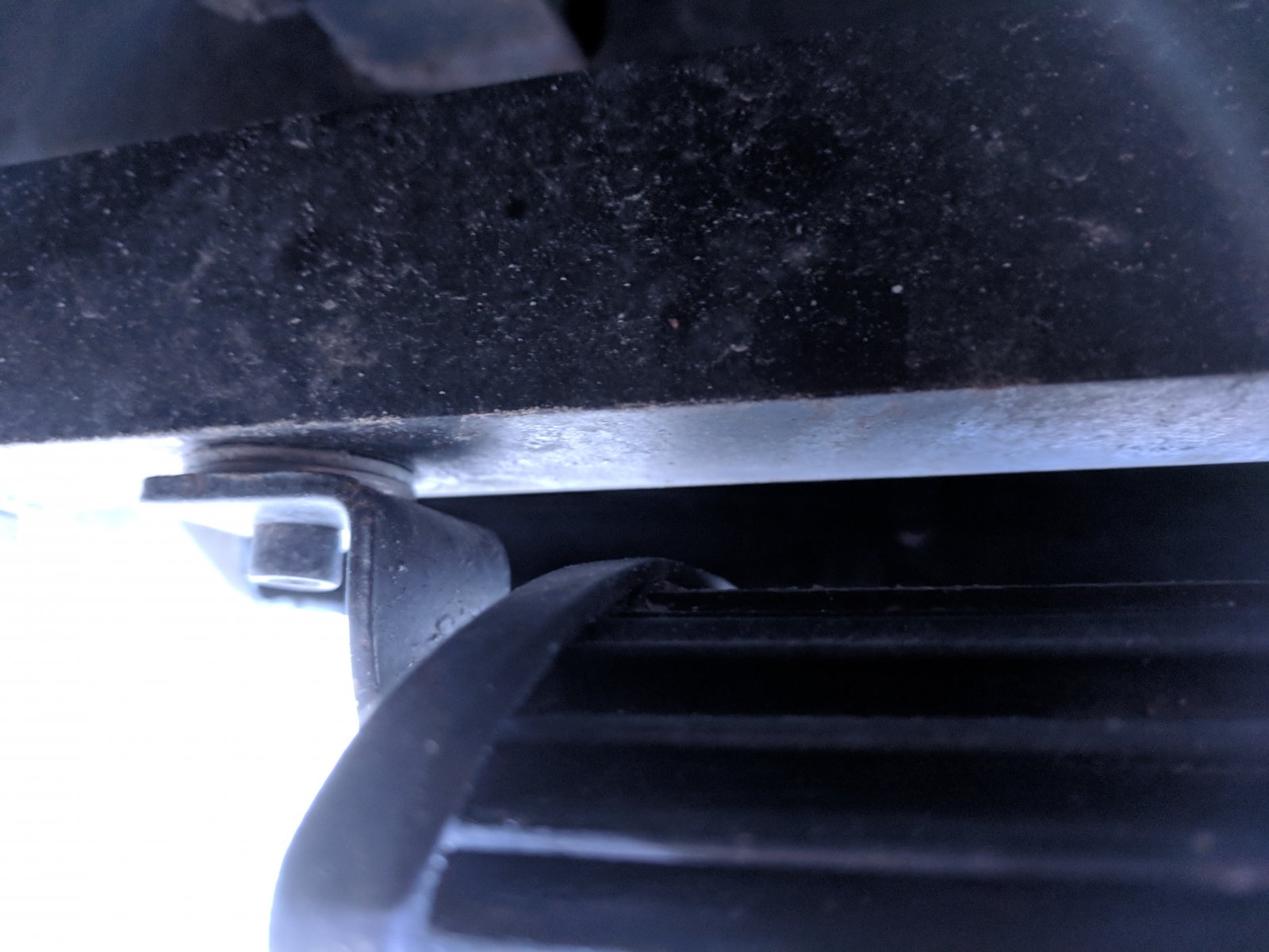

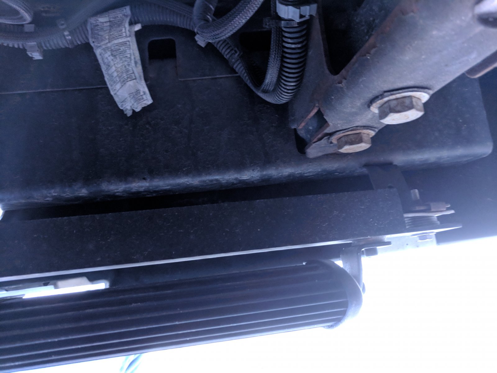

I know that this is an older comment on an older thread, but I was wondering if you had photos of where and how you mounted these? I finally found lights I want to mount like this.
10,520
15,263

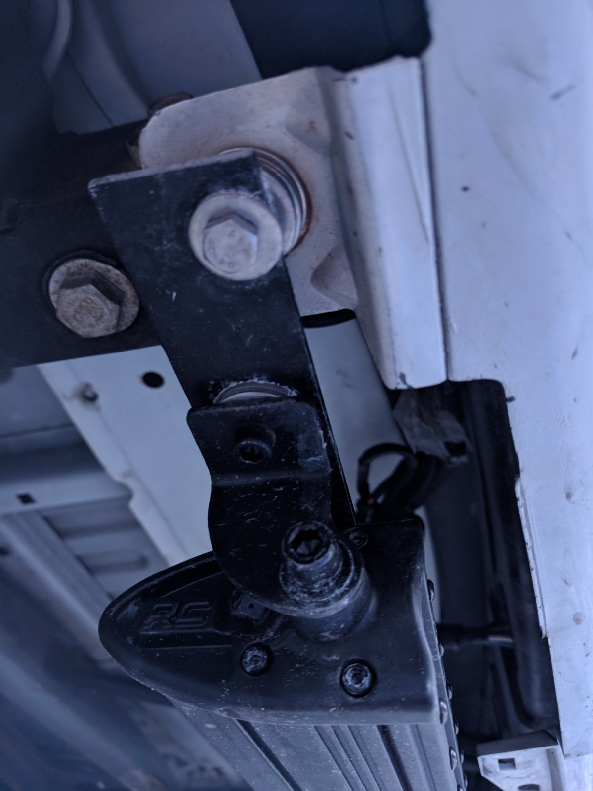

Sure do.
The mount design was easier for me than it will be for you, as I don't have a spare tire (dual exhaust sacrifice), I was able to use a single piece of angle metal stock to hang both LED units. You may need to design two independent hangers for your setup.
