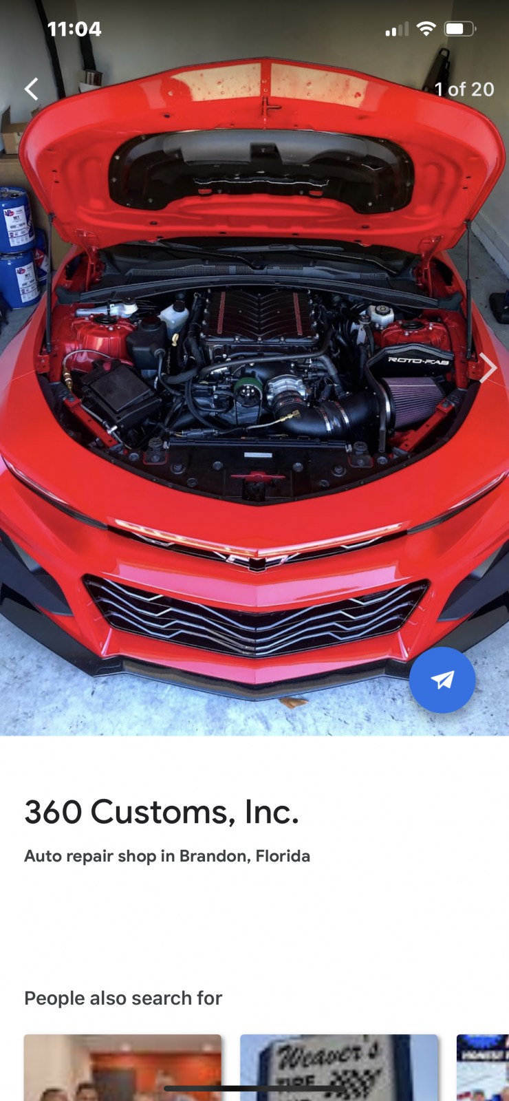

360 Customs just east of Tampa put in Texas speed DOD removal kit AND Dyno tuned it on their Dyno. A “ Perfect job and just to try for milage at 55 I got 27.8 for a 25 mile range BEST

360 customs did my AFM delete Texas Peed parts @ Dyno tuned on their Dyno.
a great job & I got 27.8 @ 55 for a 25 mile stretch !
