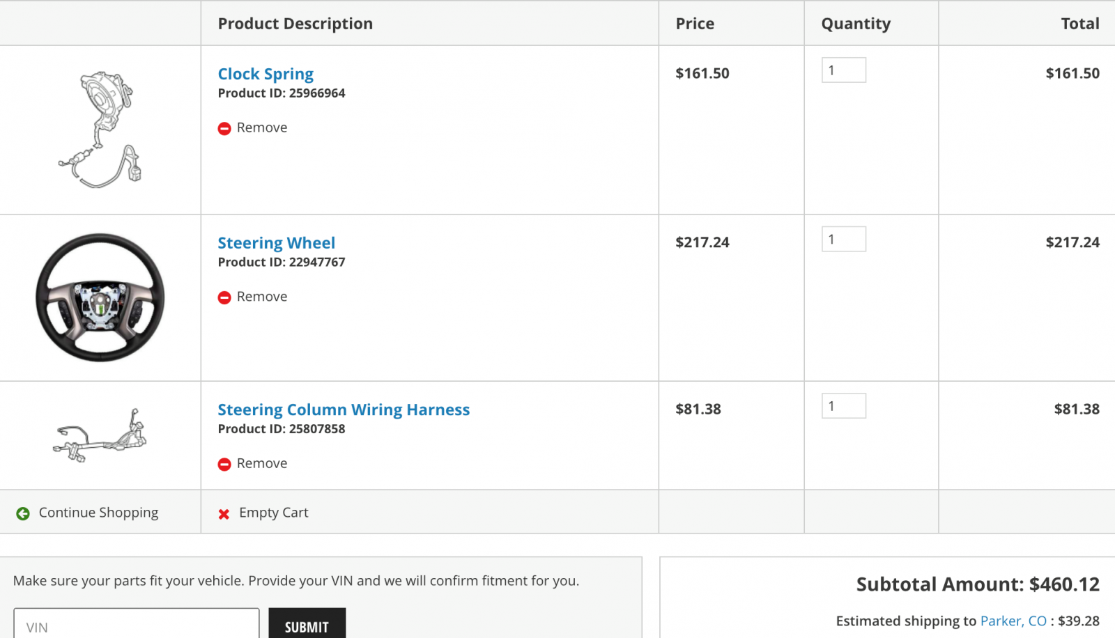

New to the forum but I’ve had my Tahoe for a couple of years now. I live in Colorado and would love to add heated steering wheel to my 2009 Tahoe LT2 Z71. It has everything I need except for that.
I found a post that talks about how I need a few parts and it should be plug and play for the most part.
My question is if I can find a VIN from someone to order black heated steering wheel and clock spring, that will make it much easier to make sure I get the right part for my 2009.
I’ve seen two different part numbers between leather color options and a wood steering wheel option. I just want black leather to match my car.

Do those look like right part numbers though? I can start my search to see if I can find them? I just don’t want to order something that isn’t right or won’t fit.
That’s all I need, those 3 parts?

you need the clockspring and steering wheel, for the heated option to work I think you need to add a "power wire" from probably the lower kickpanel to the clockspring? I am not sure on that part a couple members have done it before hopefully one of them will spot your post and chime in.
because the vehicles that did not come with heated steering do not have that wire.
