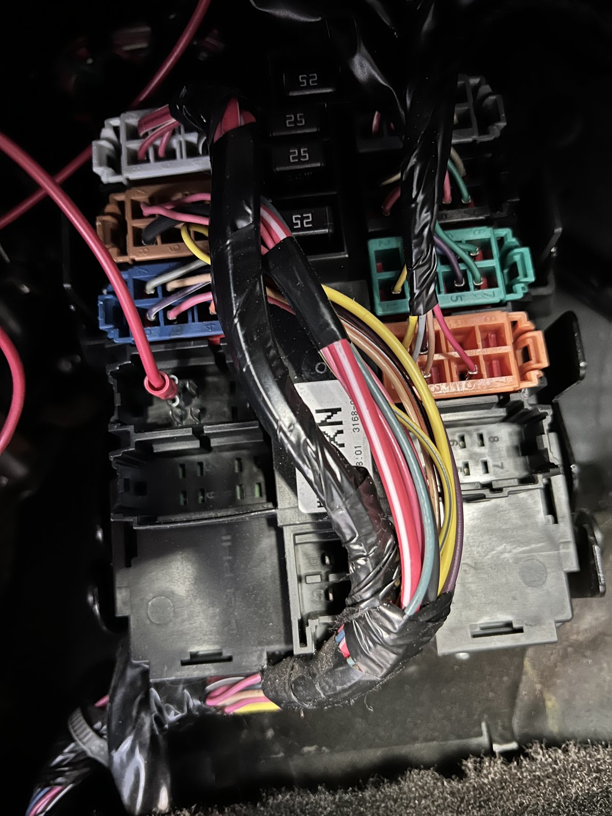

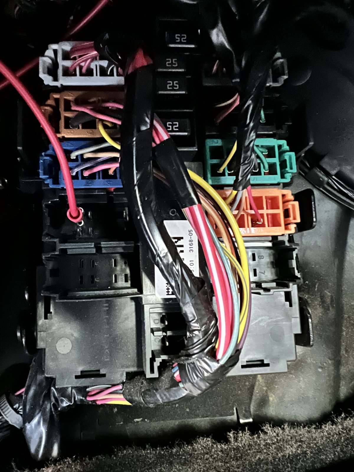

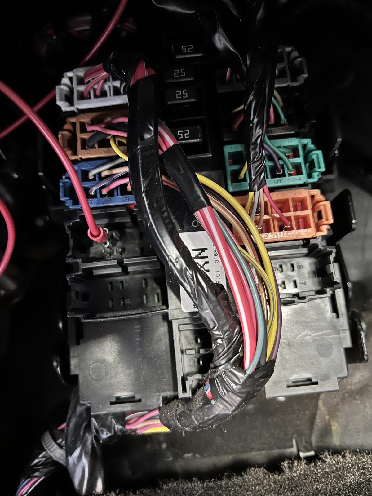

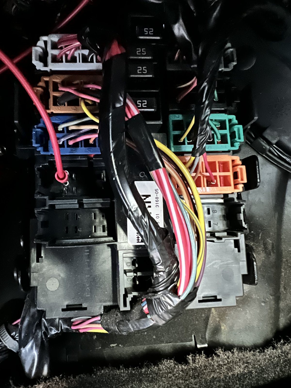

For people who need an answer, I plugged the power source for heated steering wheel to BCM under the drive side dash. I will try to post some pics later today.
I tried one spot with a spade connector first and it wasn't getting enough power for heat will turn on and then off on the steering wheel. I found another spot using test light and this one seems to work better. I haven't done a long term test on a long drive, but it didn't turn off like the first time. Do not use the fuse box. Use the BCM under the dash that is RAP or only on when car is on.

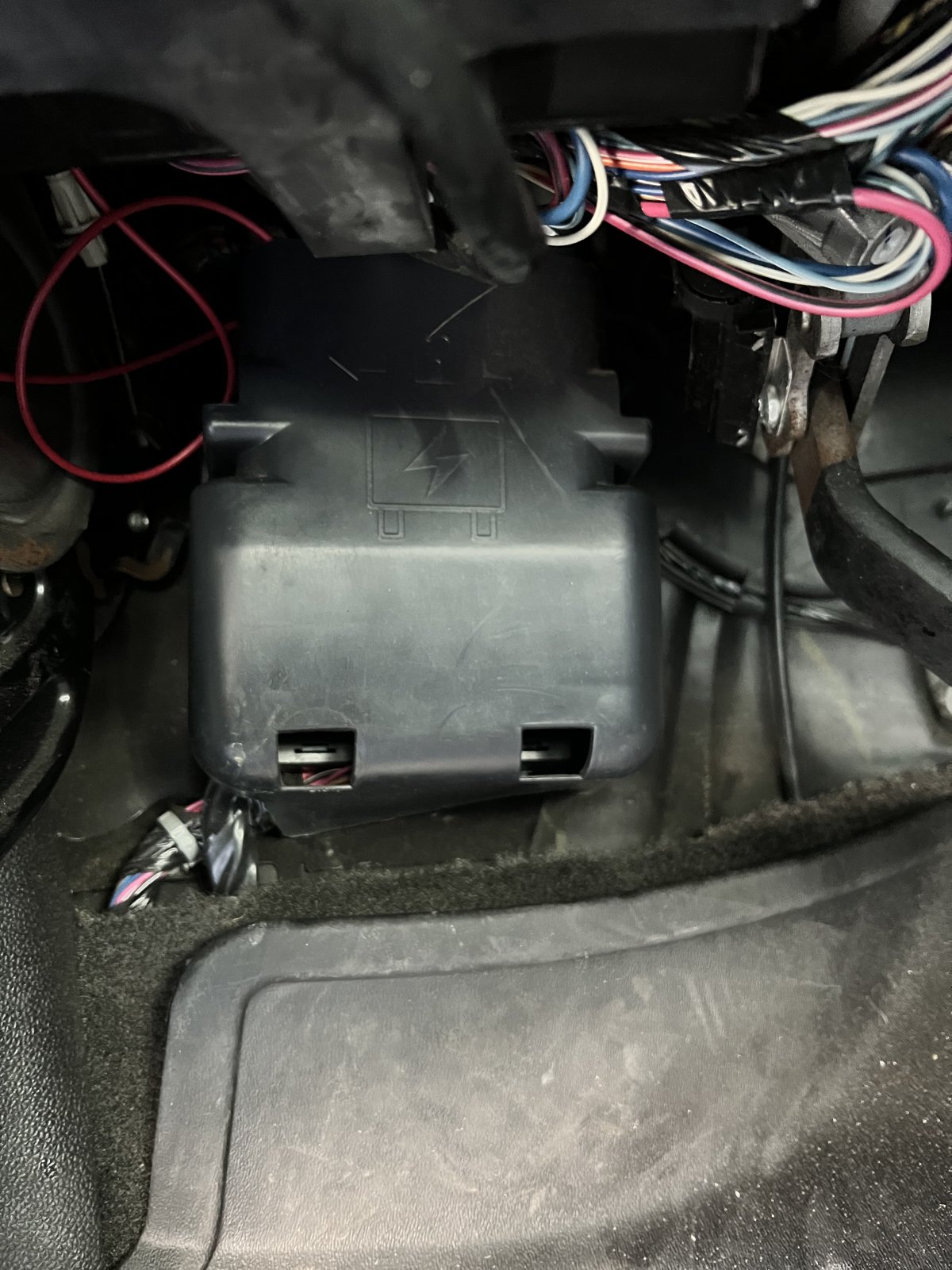

That's the upfitter box.
I used it to wire my dash cam. I was able to get ground, constant power, ignition switched power, and RAP (retained accessory power) from there.

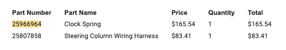

Hey Amaster, I ended up getting the harness like an idiot but you only need that clock spring that has the wire for heated steering wheel.
Harness doesn't do anything since BCM is not programmed to even recognize the wires for heated steering wheel through the harness.

No. If your Tahoe didn’t come with heated wheel, you won’t have that plug coming out of BCM. You need to find your own power. I gave it power from the module underneath the dash. Pic is attached a few posts ago

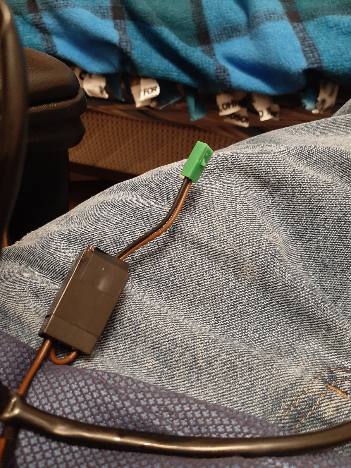

How did you connect the wire to the coil at the steering wheel? I've had zero luck finding that green plug
Clip the green connector off, brown wire goes to 12 volts, black ground. If you have a Yukon you should have the heated steering wheel plug port down in the upfitter box.
