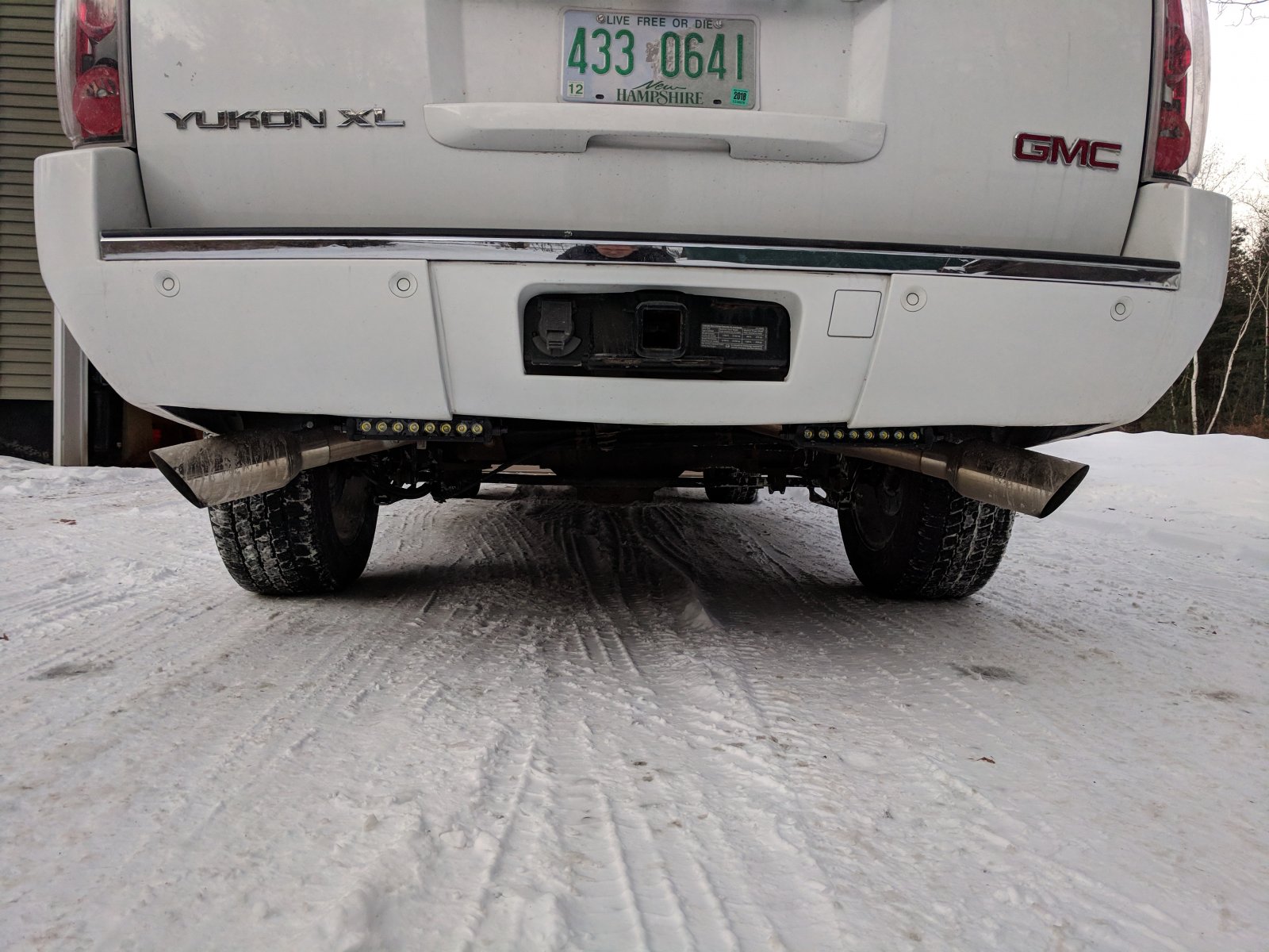

I can't help you on that, but I know how poor the stock backup lights are.

For the backup light operation, I have a wire going from the backup light circuit, the positive wire to the bulb, to the trigger contact on the relay. That's what activates the backup LEDs when I put the shifter into reverse to back up.
For the work light operation, I have the switch that I installed under the dash, with one contact of that switch connected to the same 12-volt feed wire that I used for the backup LEDs, so there's always 12 volts available on one contact on that switch. Then, I ran a wire from the other contact on that switch back to the same trigger contact on the relay. When I turn the switch to on, I get that direct 12 volt feed that goes right back to the trigger contact on the relay, thus lighting up the work lights.
