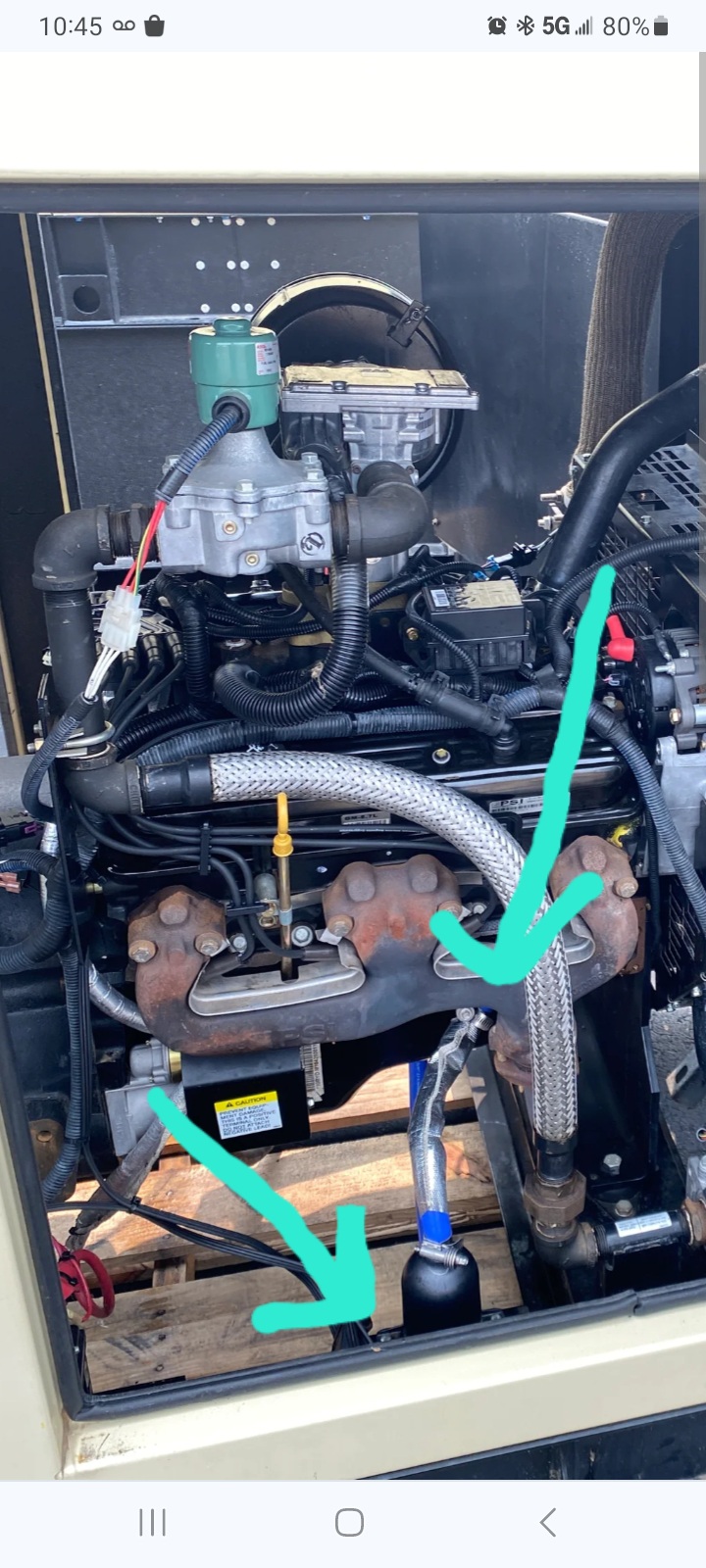

If you choose to do a coolant type, you'll have to drain all thr coolant to get the freeze plug style in the block. I'm not a fan of these for many reasons. Your other option is to find a threaded block plug, install a hose barb, and use a stand alone heater that works off convection. The outlet will need to dump somewhere higher up in the block system. (Maybe even a heater hose or waterpump connection) You just want to make a circle effect in the block, not the radiator.
Generators use these and they work very good and have a built in thermostat. It will require more work, but is easy to service or replace as needed. Just make sure to put in ball valves at the hard connections (block).
There are other models that have a small circulation pump as well.

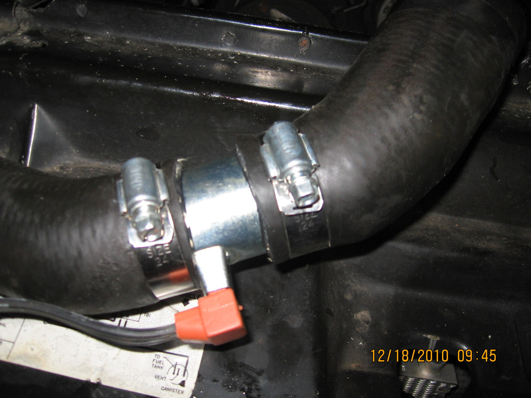

I've used the one in the past on my older squarebody's that go inline with the main radiator hose. I installed them on the lower hose so the heated coolant would rise through the system. Left plugged in overnight at 21* the next morning the cylinder heads would be around 80*.
