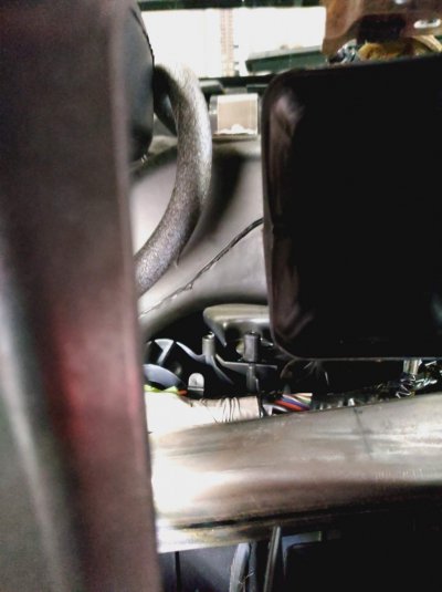

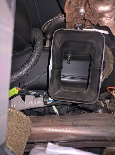

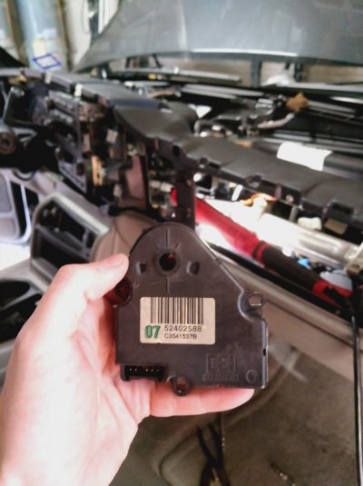

Passenger temp is the one under the dash cover. I did mine fall 2020, it wasn't terrible but time consuming and lots of steps. No more heat on my passengers during midsummer in Texas!
I'll try and get the service manual location pic posted later.
On these pics, you can see where the actuator is to the bottom left of the center vent and the next pic is with it removed. On my phone and can't figure out how to circle it, but it's half under the gray tape of wires. Last pic is the old one removed. IMG_20201102_134521.jpg

Thanks Mattbta. Yep, I was changing out the incorrect actuator and through some research found out about the one you pictured above. Interestingly enough, I took it to our local shop who works on the Tahoe and they had replaced that actuator last year for the previous owner. He told me that it was still under warranty and replaced it for the price of labor. It ended up only costing $190 to replace the correct actuator and now everything is working correctly. Thanks for all of your help and glad its done now that the temperature is starting to creep up....
