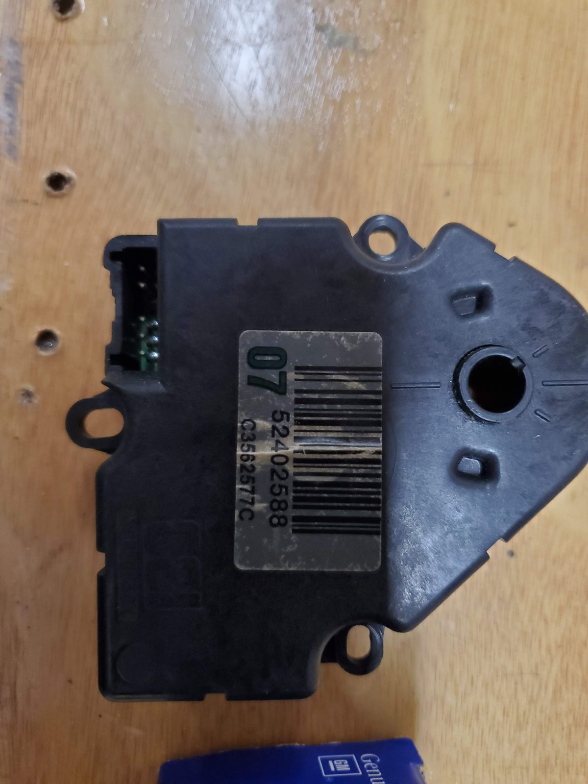

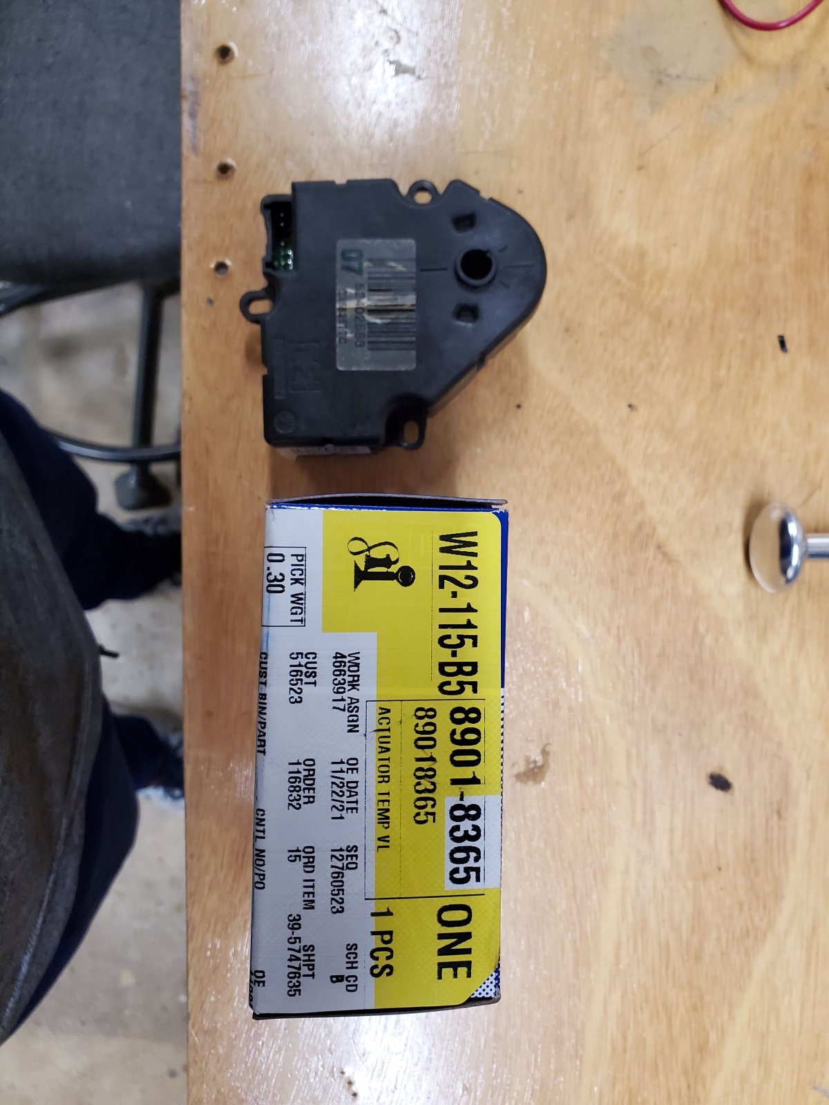

Update. I called the local dealer, gave them the last 8 of my VIN, told them which actuator and they said they had one... $278.00 which is almost a tank of gas today! Anyway, picked it up and it doesn't work. Here is the picture of the one I removed and a picture of the box the new one came in. The picture of the old Dorman actuator 52402588 or 604-106 seems to cross-reference the GM part no# 8901-8365... so at least it seems to be the correct part. If it doesn't work, what else do I need to be looking for? I would assume a bad fuse, but not sure I know which one, it indeed it is a fuse...
Not sure if you’ve tried this but have you tried ‘recalibrating’ this new Blend Door, once installed? Too much to explain here, but you can watch YouTube video as to ‘how to’. Also, did it work at all for hot or cold airflow, once new B Door was put in? And was the power plug seated properly? I remember the tight quarters made it hard to work on. As far as checking fuses - it it does anything at all with power on, prob not a fuse.

Great question and something I left out of my detail above Rolexus. Once installed, I disconnected the battery for about 30 minutes (had to run to the store while it was disconnected) then reconnected everything, cranked it up, made sure the A/C control was off and drove around for about 10 minutes. Once I turned on the air, same as before... Heat out of the passenger side, cold out of driver side. Also, while I had the actuator off, I did cycle the blend door to make sure it wasn't broken or bound up. It moved very nicely from side to side.
