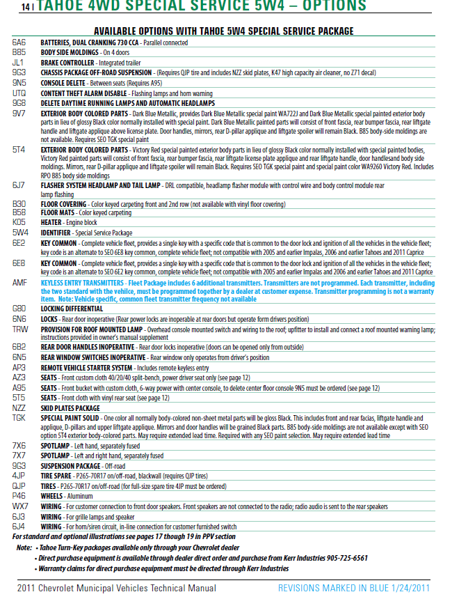

very nice, hard to find RPO list, I need to copy my glove box RPO build sheet into an excel or something and decode everything....I did a TON of decoding (including my truck before buying) on all sorts of trucks and they all start to bleed together but I def have both the rear door inoperable by rear passengers and rear window inoperable by rear passengers.

I used this list; http://d354nuoz4t18d4.cloudfront.ne...89e6/images/custom/rpoCodes.pdf?cb=1497380755
I don't know if it is complete, there were 2-3 things I didn't see on there.

I spent forever on the RPO codes. Used multiple sources to fill in as much information as I could and then used and Excel sheet to do lookups on the various sheets.
Then found out GM is on this forum, simply send them your VIN and they will provide you a complete build list for you vehicle.

I have a sticker inside my dash glove box that I'll go get a pic of, basically says "This car has had aftermarket LE installations in it and should only be serviced by XYZ and here is the number"
Do we have a user name I could message? Also we can add that at the top of this sticky = " GM Forum Account for Build Sheets/VIN Decoding" with complied RPOs and descriptions to prevent stupid, simple questions from having to be emailed or PMed.

*****PLEASE FEEL FREE TO MSG OR POST ADD-ON'S TO THIS LIST, ANY LINKS OR INFORMATION IS GREATLY APPRECIATED!! *****
I think we should have a sticky at the top of the PPV and SSV forums, with the basics about getting our trucks back to a more "civilized" form. We can also have a breakdown of the differences between civilian tahoes and PPV and SSV + other Fleet optioned vehicles.
The goal would be a comprehensive list of the basic stuff we all (or most of us) encounter when we bring our Government Owned Tahoes home with us for the first time.
