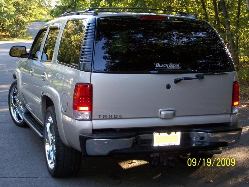

I took off my side molding (can't believe I waited so long), put on my new LED tails, and put the 2/4 belltech kit in. Check it out

looks great! what method do you use to remove them? I was worried about doing it on my 03, I didnt want a fade line left because mine is black.

I used a heat gun and just pulled it off,then I had to used goo gone to get all of the tape off. Once it was all off I waxed and polished the area.

i started to use a heat gun when i took mine off but eventually it wasnt worth the time or burning my fingertips so we just pulled them straight off once we could get a hold of them. youll have to peel off all of the black stuff that holds them on or whatever it is and really clean up the revealed pant. mine looks good just at first glance but if you really get close you can see imperfections all the way down both sides and same way with all the badges. im sure i could get it looking perfect like the rest but im just to lazy
