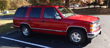

With traffic/humidity/low air flow and rpm's, leave on MAX , lower blower speed to second notch, slowing airflow allows evaporator to cool better. You have all the engine heat plus firewall heat and none of these on the rear ac. once the initial cool down, lo blow will give you 40 degrees @ the center outlet. How do i know, because mine does it, highest it ever gets in bumper to bumper is 50 degrees above 90's outside.
226k miles, all original including engine/ac complete........good luck.
