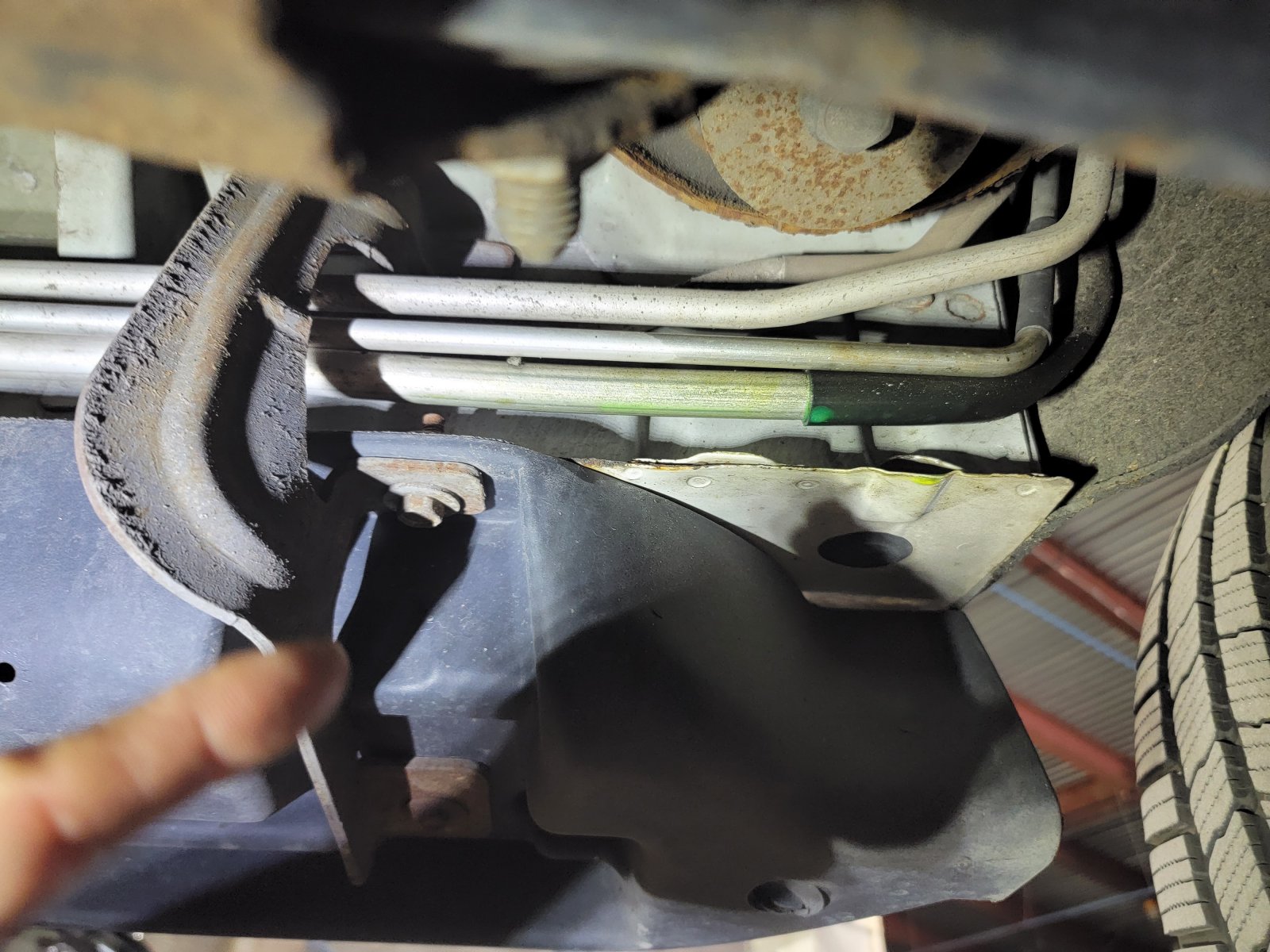

I need your help with my 2017 (43k), long story short the a/c wasn't great yesterday morning on the way to work but by the time I got out it was blowing HOT air. Seems the rear lines are leaking in at least two places. One small leak at the solid coupling (first pic) and a larger leak that up the wheel well (second pic). They mentioned you have to remove the body from the frame and that I should see if the dealer will warranty it as there was a TSB regarding condenser issues extending it to 6 year 70k. Obviously two totally different issues but who knows.
Anyone run into this problem with a 4th gen?
Thinking about buying the rubber replacement hoses and leaving the stick hard lines in place.
Any suggestions?
