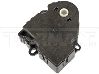

I found the model for the resistor (Dorman 973-401)
Which one is for the air blend door actuator? I found 3 versions of Dorman.
604-106

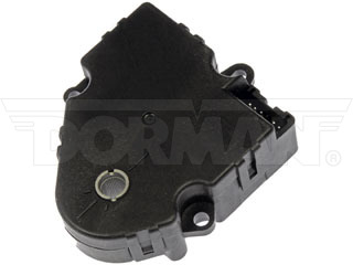

604-112
HVAC Air Door Actuator
Application Summary: Cadillac 2014-03, Chevrolet 2014-03, GMC 2014-03, Hummer 2009-08
Application Notes:
Main; Mode

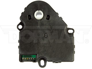

604-184
Air Door Actuator - Auxiliary, Mode
Application Summary: Cadillac 2014-09, Chevrolet 2014-07, GMC 2014-07
Application Notes:
Auxiliary; Mode
Auxiliary; Temperature

none of those, the oem rear blend actuator is AC DELCO 1572972 {#89018375}, which crosses over to a Dorman 604-111
the hot/cold blend actuator in the rear will be the one closest to the blower motor, the one further up is for up/down air flow

I got my new blower motor actuator but issue remains. The new one made by Dorman works. It has way more metal rods but they are thinner than the OEM Bosch one. The problem seems to be in the wiring, specifically the purple wire going to the motor. When I play with it, the motor turns on and off. I ended up pushing it deeper into its socket point in the motor and it seems to stay on even after a drive. Seems like just a loose wire I hope. This did not improve the rear which still blows hot air. I want to get the recommended AC DELCO 1572972 {#89018375} / Dorman 604-111 but not sure where it goes. Some videos show an option under driver gas pedal but i had trouble finding this on mine. I only see the one on passenger side.

the 604-111 goes in the rear hvac, nearest the blower motor. the front ones are different model but the hot/cold will always be the closest one to the blower motor. you can pull your old one out and match up the part number to be sure.
