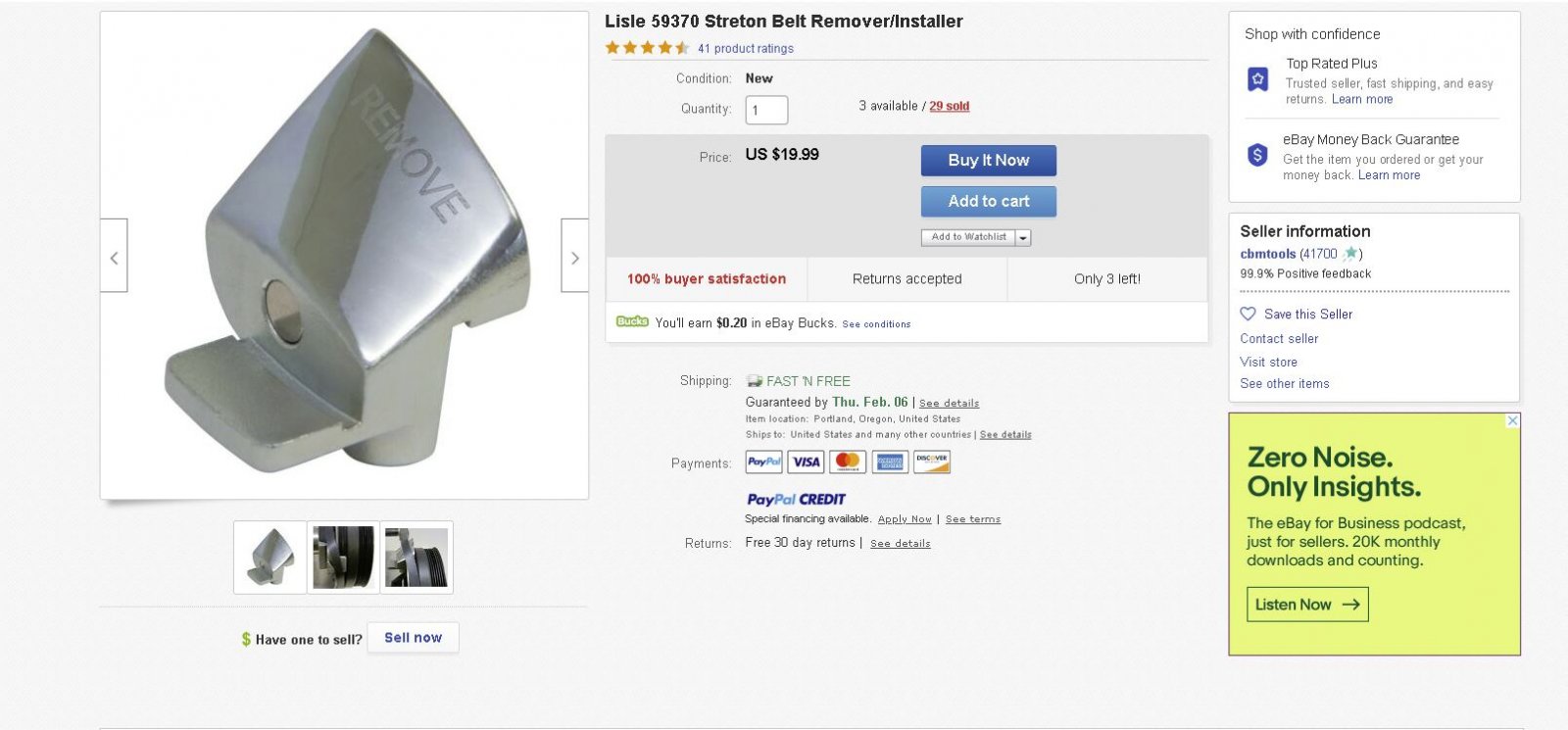

this is the tool you want right here (lisle 59370), it is magnetic and sticks to the pulley, removal is REALLY easy, flip the tool and install is a little tricky because you have to place the belt and tool in just the right position or it will hit on a metal protrusion around the crank pulley, but overall easy and a handy tool
Geotrash
Dave
Feb 16, 2018
7,849
20,430
Richmond, VA
+1 on the Lisle tool. Easy job once you know how to do it. I also like not having to worry about yet another tensioner bearing going bad.
