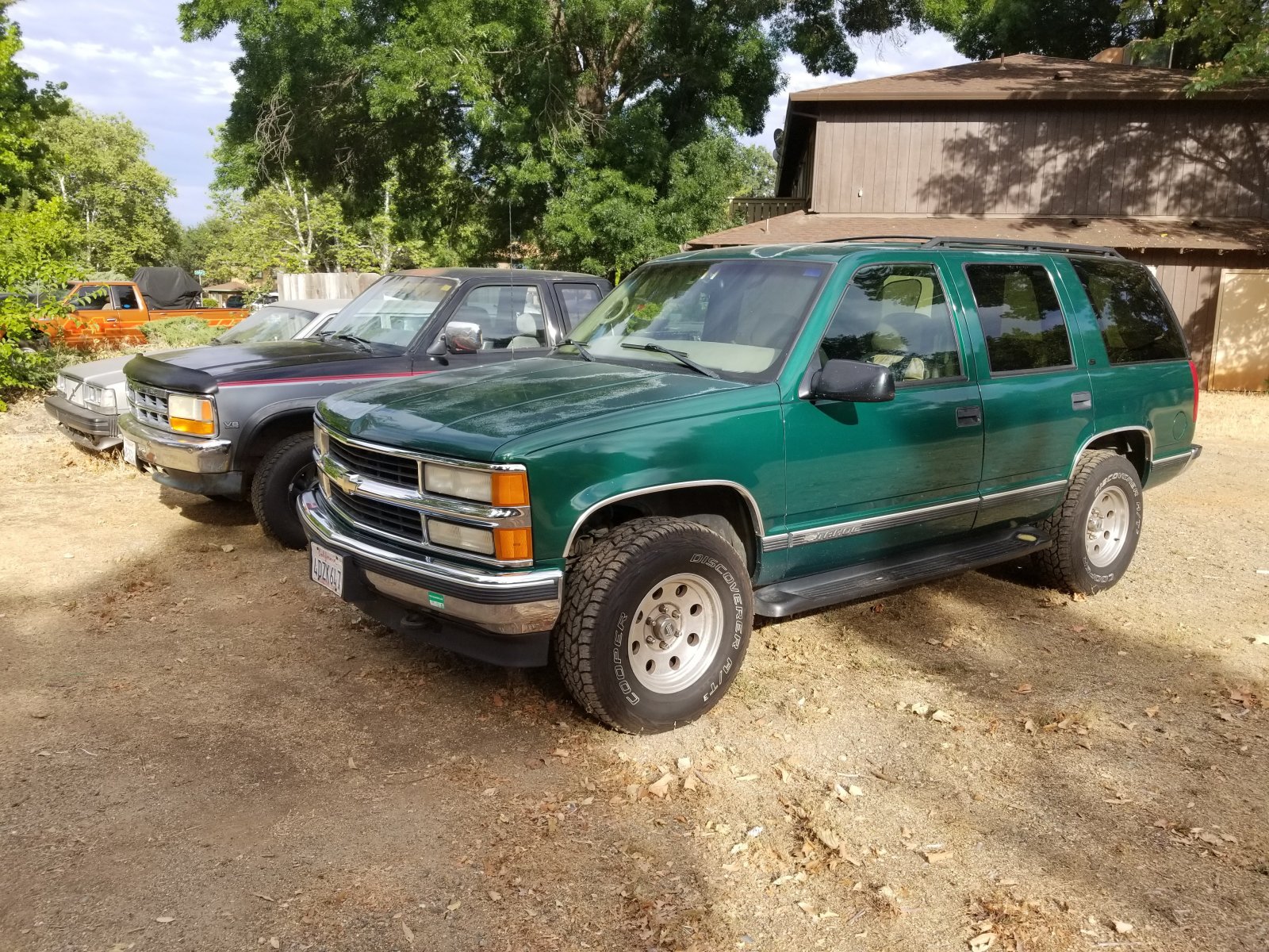

Hello all, My question is what is the starting out in 2nd gear all about? and why would they not let you manually shift to 1st gear, I've been putting my Tahoe in 4 low on the boat ramp because it would have a hard time pulling itself up the ramp, then I find out if I put in 2nd gear because the shifter wont go to 1st gear, it stays in 2nd gear??? why the hell would you want that? here's what I found online and it's not much, from a add and a form. thanks.
