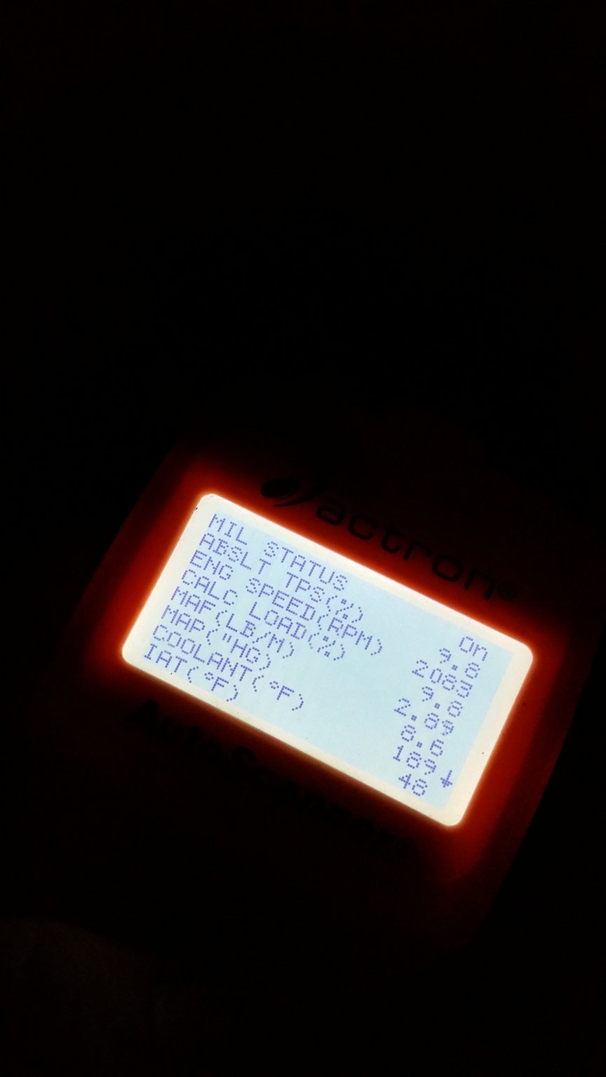

Maf reads between .86 to 4.3 lb/m between idle and say 70% TPS. Map reads at a steady 9.x "hG during idle. Drops slightly at 2-3.5k RPMs,to say 8.x "hG and if i let off the gas quick drops to 6.x"hG. IAT readings are correct in relation to OTemp.

See pic
