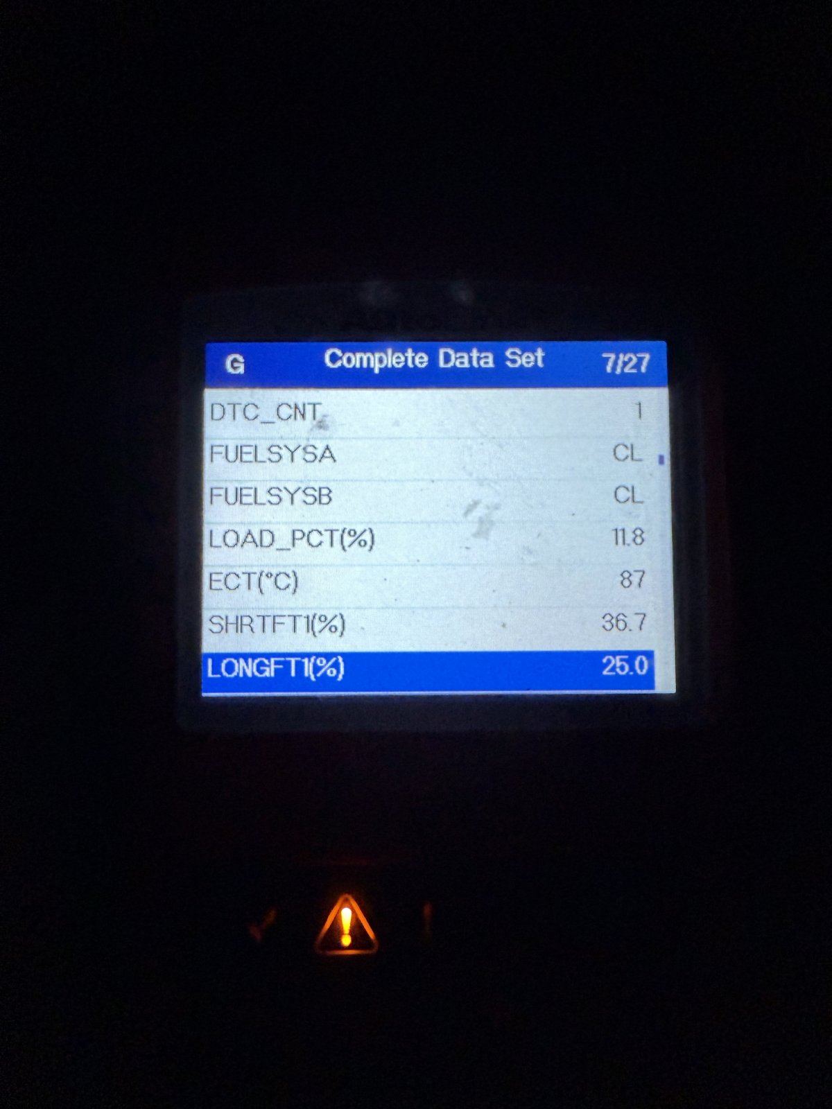

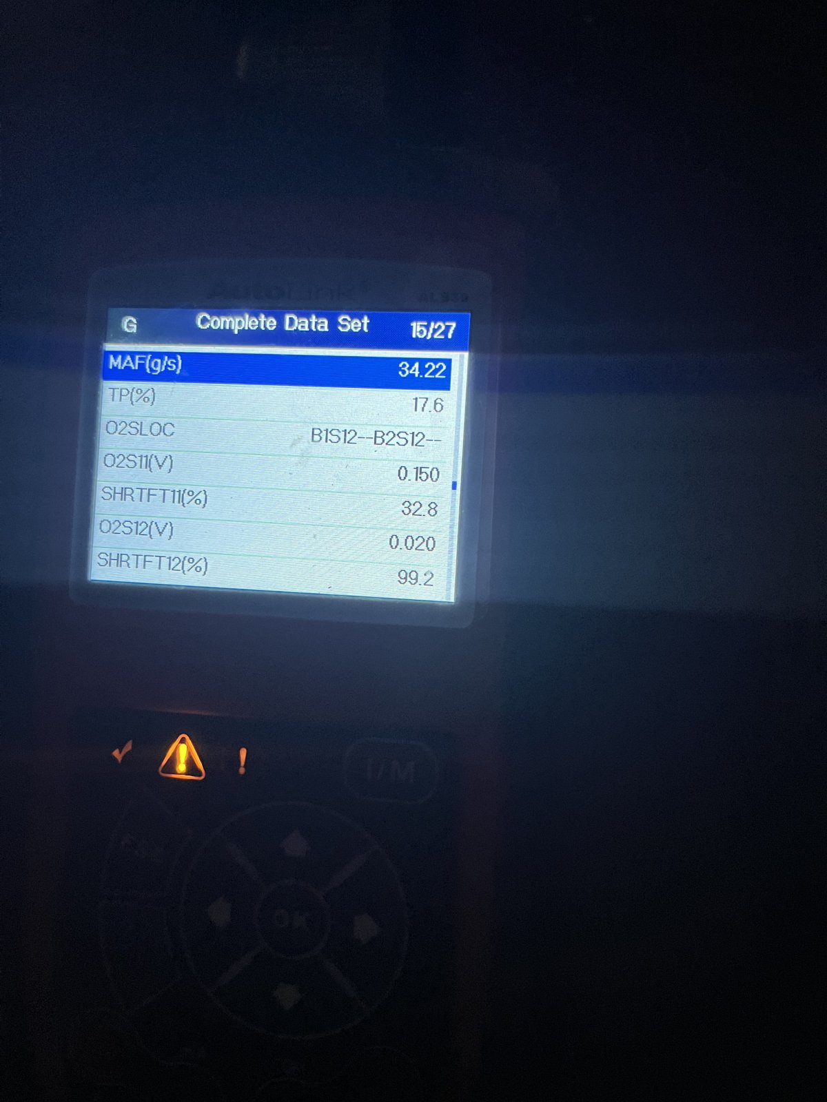

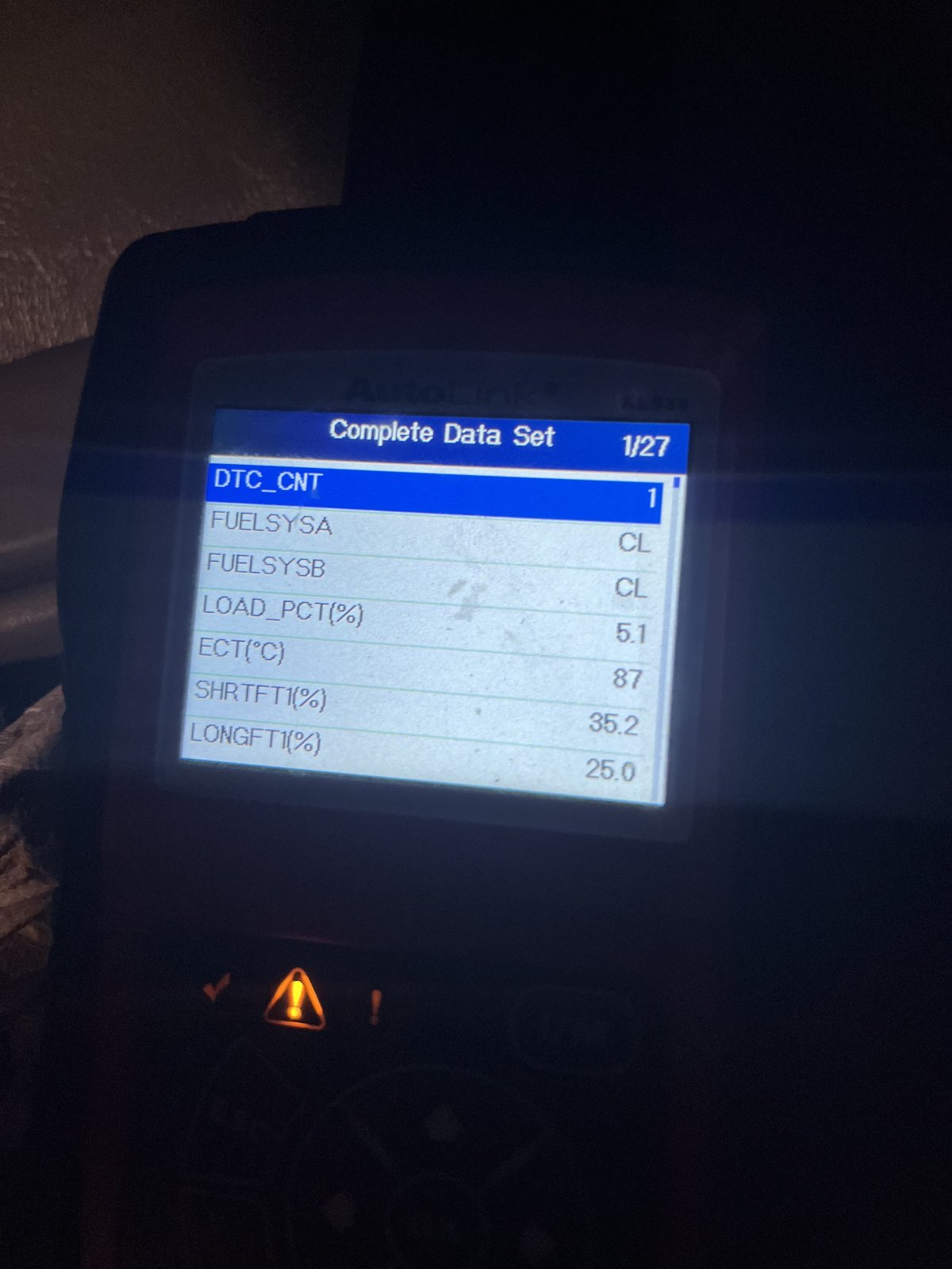

Just replaced my 5.7 vortex with a brand new crate engine, everything went good but now it’s throwing the infamous p0300 code and just wondering if anyone else ever had this issue or knows what I can do to fix it thank you

It's running lean based on your short-term fuel trims (fuel is being added -- a lot!). One possibility is a vacuum leak, or something else could be causing that. Check the intake from the MAF to the throttle body to be sure there aren't any leaks in that plumbing. It could be a hose left unplugged, or damaged.

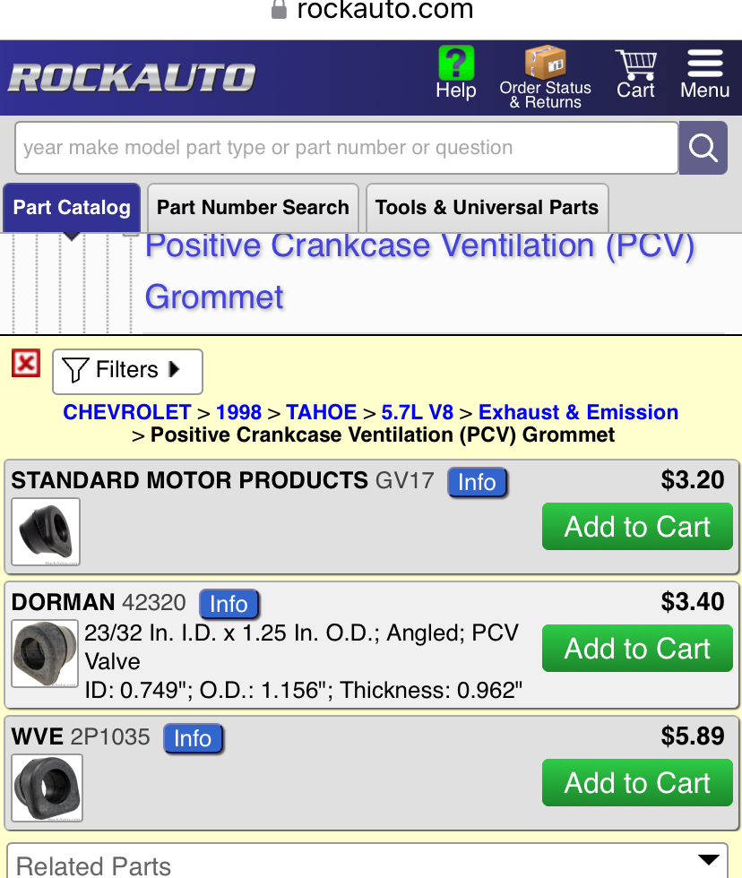

So, a quick update, replaced the pcv valve along with the hose connections, and it’s not bogging down when I take it out of park, still throwing the code and running a little rough, gonna dig some more into it this weekend, would any one suggest getting new grommets for the intake?
They can seep oil over time, wouldn’t hurt to swap them if they’re original. They’re the same part for both valve covers.
