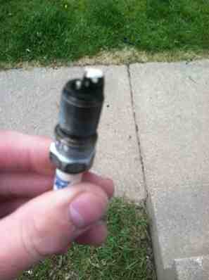

As for trying to figure out what the issue is, I replaced the cap/rotor, about 500miles ago because the truck would not turn on, yesterday I went ahead and replaced all the plugs, and found that the plug from cyl 3 was fairly burnt up , pictures can be posted if need be , otherwise all the other plugs were fine. I also contacted summit to warranty my wires out so if that doesn't' correct the issue , I am more than just confused.

a cat does not cause a misfire but a misfire can ruin a cat. Let me see pics of that plug and say #1 or #5 as well. and did you put delco 41-993 plugs in there now? What ever has gone wrong in #3 once the issue is fixed I am afraid your cat system may finally be fried.

Cylinder 3 sorry it's really blurry

you either have an oil control problem thru the piston ring or valve seal or coolant is leaking in there. solve that and the ash deopits will stop. the deposit build-up what ever the cause is causing the cylinder to go dead ignition wise. I hate to say this but with that much crap on it :imo: you converter is fouled as well as the oxy's are most likely fouled a bit too.
