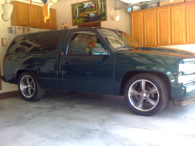

btw here is my pops truck
275 45 20 front
295 45 20 rear
I think rear was at 30 and front was at 30.5 im going to pass by there tomorrow again I can measure it for you

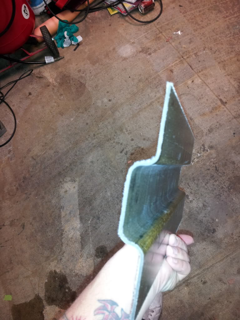

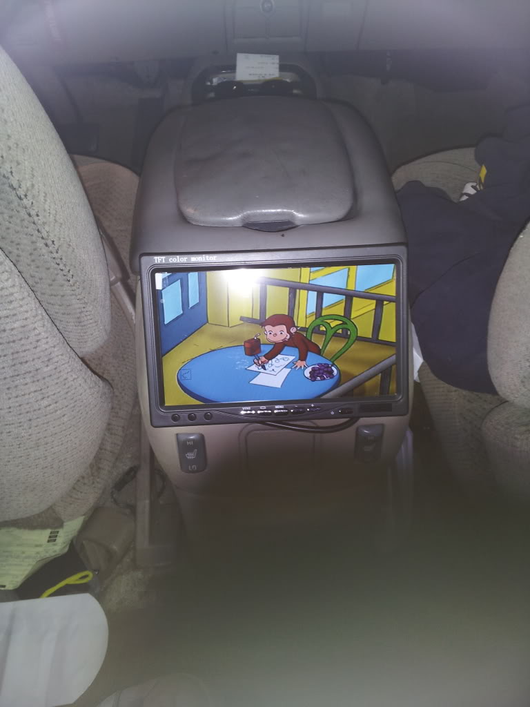

Not too bad. I'm going to Fab a better bracket tonight at work and adjust the cable but all in all the boy liked it. Its for the kids. They watch movies on their tiny iphones so this is an upgrade

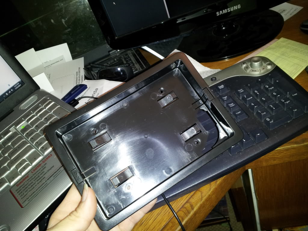

That's a 7" right? I'm thinking of making a center console from MDF with my screen in it, but threw that headrest adapter away when I bought it. Would you consider selling yours?

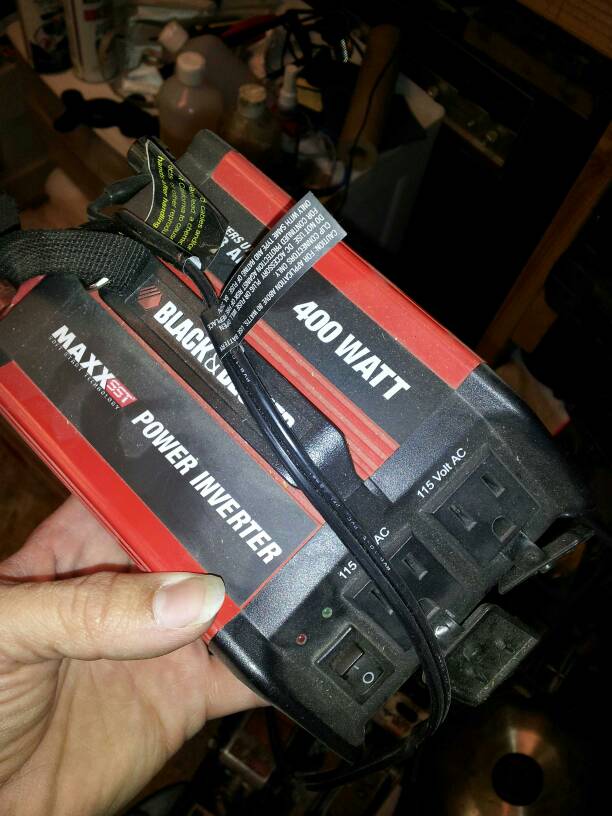

A small power inverter with outlets back there for the kids would be nice for road trips and stuff.
slipping
slipping
Mar 21, 2010
1,043
25
Rosamond, CA
7" yes. This one?
You can have it. Good idea with power. I have a 400 watt 2 plug one.

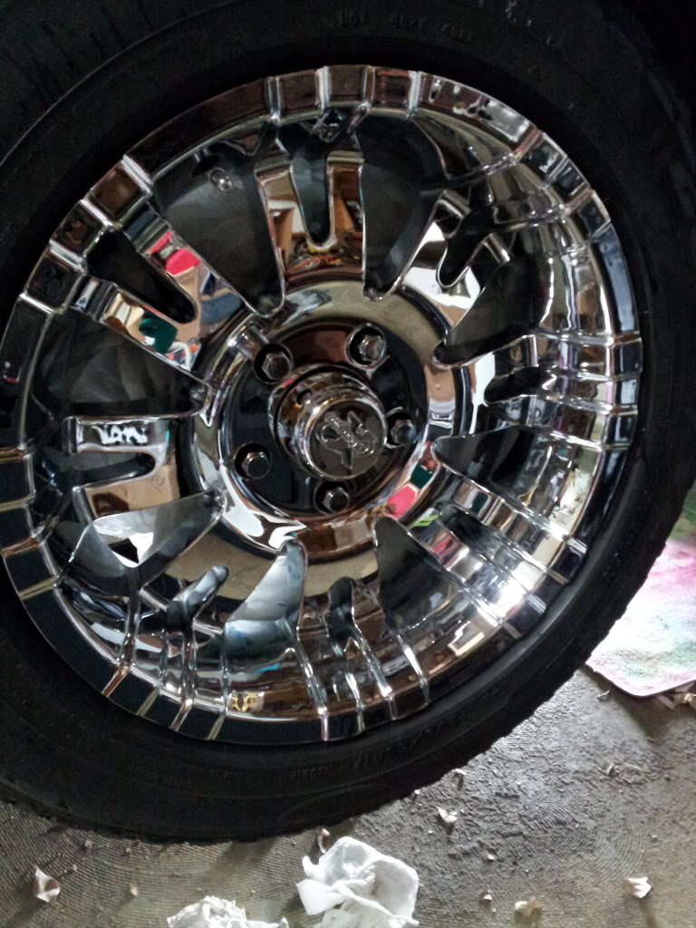

Played with pearlizer on black
Glossifier on black
Pearlizer on chrome

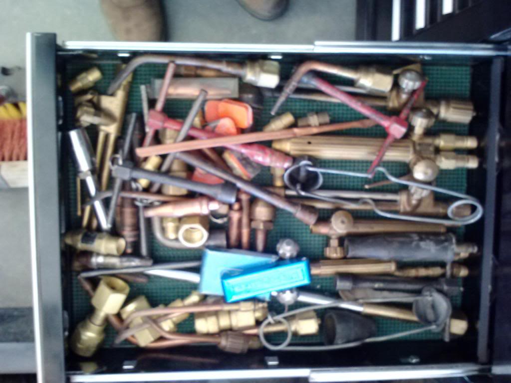

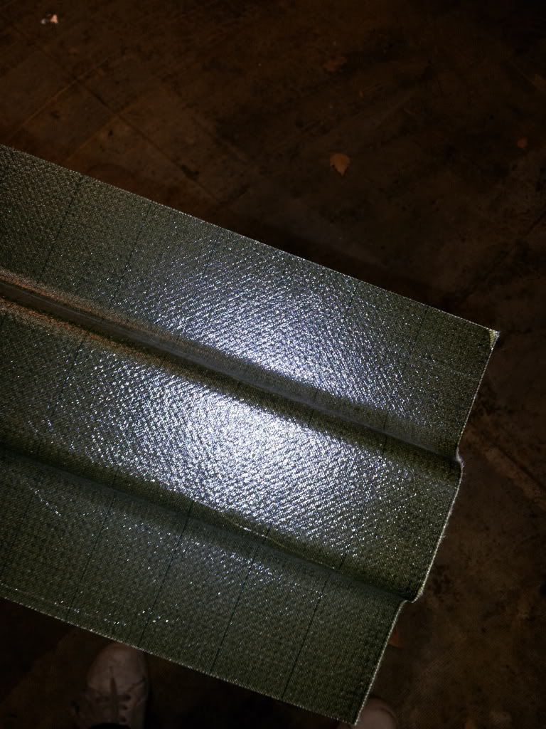

Got some carbon to make bracket for TV
Then buddy offered me his torch, tips and handles for 125

I like the pearlizer on chrome looks best.
slipping
slipping
Mar 21, 2010
1,043
25
Rosamond, CA
the pearl on chrome is different and looks better and different than the pics. I also like the black pearl. need to do some gloss on the black pearl. i just like playing
