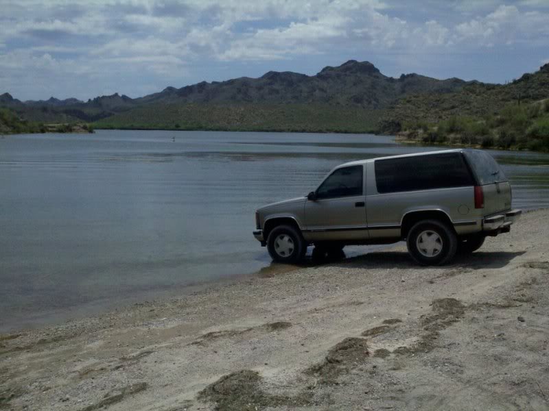

I just bought a 99 Hoe LT 2dr 4WD 192k on the engine, 30k on trans, new flowmaster exhaust. I also live in the warm state of AZ. During the day its 110 out. The problem only seems to happen mid day after its been parked in the heat for a while. When I start her up and begin to accelerate it bogs till I give more gas and then it resumes to normal. I am thinking any of the following. EGR, fuel filter, injectors, or who knows what else. What do you guys think? From what I read this happens allot but is weird with mine as it only happens after sitting in the hot sun for a while.

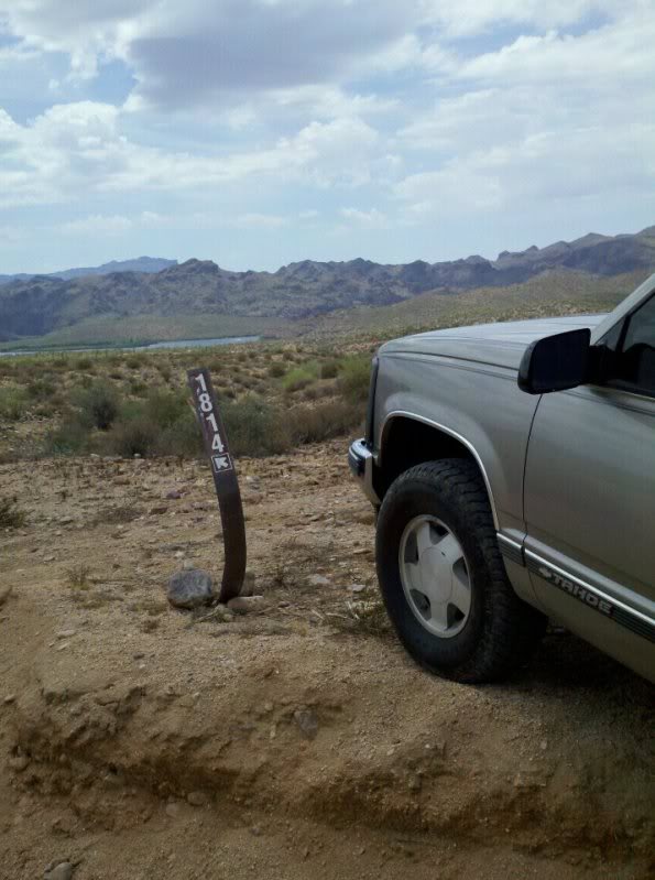

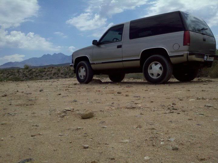

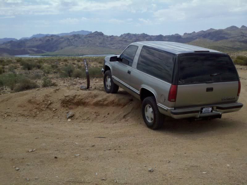

Nice 4 peaks in the background, just went quading out there a few weeks ago.

Well no mods other than the Flow master. I can feel it most when first acceleration and I then have to give it more gas which then it hesitates for 2-3 secs and then boom starts accelerating as normal. When continuing to drive at cruising speed I can feel it a little but not near as bad. Drove it this morning which was cooler and didn’t happen. Ya I had some fun up there last Tuesday.

I wish I had some places like that to go play in, amazing view.
